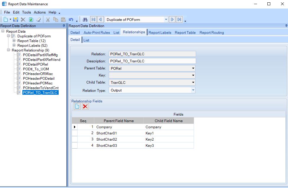

So I’m new to Epicor 9, I was in E8, 6 years ago but I have a custom PO report that includes the GL account in one company, I tried to duplicate it in second company changing the report name…everything worked except the GL Account field on the PO report, the relation is setup char01-char03 to key1-key3 as an output in the data def, any help would be great. Another IT person looked at it with me but we were both stumped as of the TranGL table isn’t working from the data def. also I believe it appears an XML was loaded as a dataset in crystal that no longer exists if that’s the cause
I did finally resolve this, for anyone wanting to add the GL_Account on the PO report please let me know

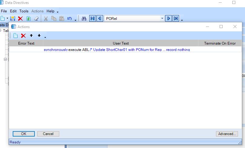

/* Update ShortChar01 with PONum for Reporting TranGLC (Before the world ends)
Jason Woods (jawoods@epicor.com)
12/18/12 */
for each ttPORel where ttPORel.RowMod ne “” and ttPORel.ShortChar01 = “”.
assign ttPORel.ShortChar01 = string(ttPORel.PONum)
ttPORel.ShortChar02 = string(ttPORel.POLine)
ttPORel.ShortChar03 = string(ttPORel.PORelNum).
end.
Epicor wrote this custom BPM to add a relation between the tables PORel and TranGL which duplicating the datadef and adding the relation for these fields

Hi ypan,
just join POrel to TranGLC
PORel.Company = TranGLC.Company AND PORel.PONum = TranGLC.Key1 AND PORel.POLine = TranGLC.Key2 AND PORel.PORelNum = TranGLC.Key3
and display TranGLC.GLAccount
good luck,
Cheers
Paul
In addition to @PaulMorgan’s joins, you’ll want to put a table criteria on TranGLC to limit the records to just those for PORel. Otherwise you might get a type mismatch. Or you could possibly pull some other TranGLC record who’s Keys happen to match the PO Num, Line and Release.
Use:
TranGLC.ReltaedToFile = 'PORel'
thanks Calvin…yes definitely required. I only told half a story, need more coffee
