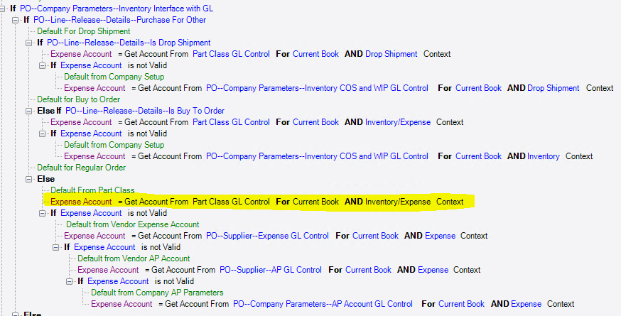

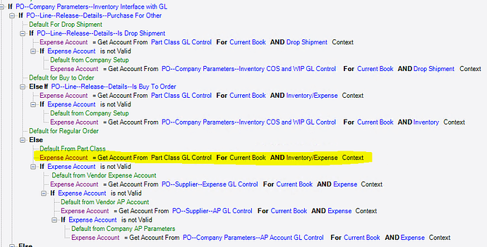

As per posting rule, it should pick from Part Class GL Control. Please check whether GL account is valid.
The Part Class I selected does have a GL account set for Inventory. What would make it not valid?
There’s a generic Expense account context in the “Inventory and COS” GLC Type, which should be applied in Company Config.
This is what would be used for a Pur for Other - assuming no other GLC applies.
Note that GL field on the PO Release sheet doesn’t automatically display a value. When it’s blank, the release will use the GLC derived acct. The Get Default button is really used to restore using the default, after manually entering some other account.

This is by design. The system won’t know the G/L account until the WIP/Recon report/capture runs the posting rules. Epicor is a multi-book system so one account number on the PORel doesn’t make sense because it could be as many account numbers to use as there are books in the system. The only exception would be Misc/Expense POs. Here you should be able to set the account number while the PO is not approved and no other activity like receipts have occurred.

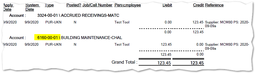

  1. I made a PO with an OTF Part using a Part Class that specifies Acct 6160-00-01 for Inv/Exp. This created the Tran GLC entry:
  2. Did a PO Receipt for the above
  3. Ran Inv/WIP Recon, and see:

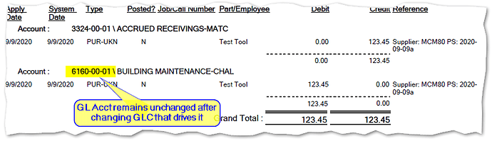

  4. Changed the GLC for that Part Class to use Acct 6130-00-01
  5. Re-ran Inv/WIP Recon. Still shows original Acct
  6. Looking at the PO Release and the original GL Acct (6160-00-01) is still shown.
So the Post Engine isn’t recalculating the Acct to use.
