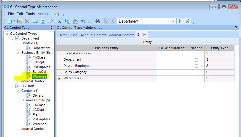

You probably need to add a “Warehouse” Business Entity to the “Department” GLC Type
Create a GLC Code for each Warehouse (like you did for each Site/Plant). But GLC Type will be “Department”, not “Division”. Set the GL acct with blanks for the first two segments (like you did for Div, but this time only the Dept segment is populated)
Then in the Warehouse Maintenance, add a GLC (type = “Department”), and select the GLC Code you created above. Repeat for each warehouse…

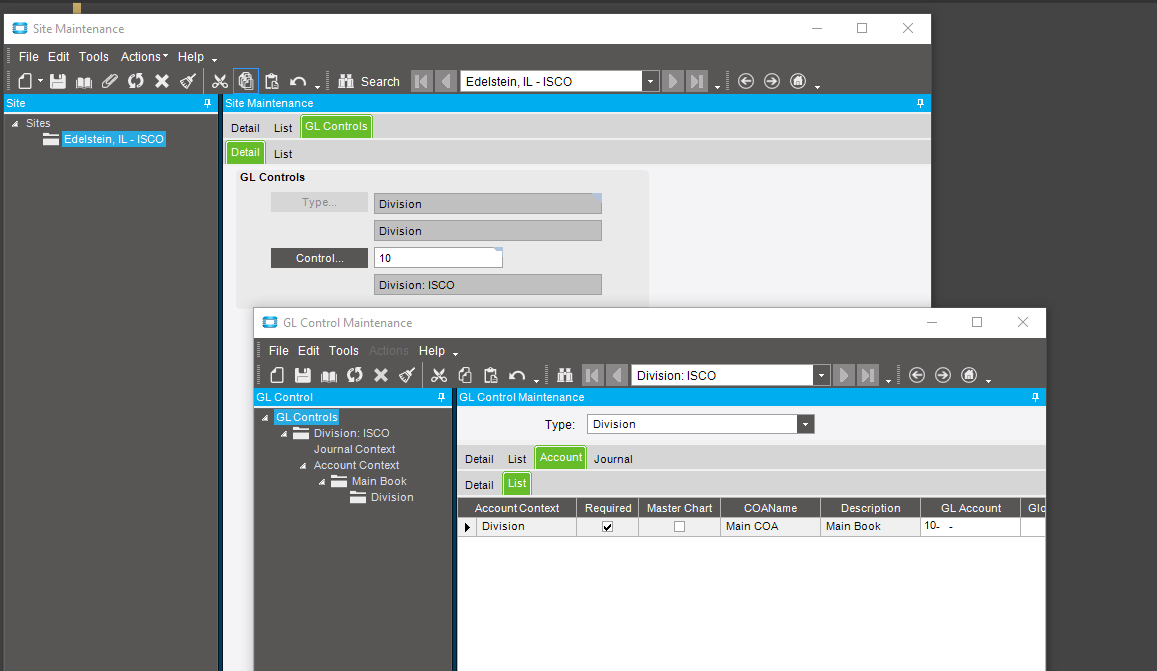

Here’s what I did for our Multi-site setup.
  1. Added the new Div Segments. Our original (single site) Div was -00-. We added 4 more: 11, 16, 17, and 18.
  2. Created the GL accounts that will use the Div field. Originally, we only had 1151-00-01 for our inventory, So accts 1151-11-01, 1151-16-01, 1151-17-01, & 1151-18-01 were created.
  3. Created 4 new GLC’s of type Division. With GLC Codes 11, 16, 17, & 18. Setting the Account like:
    (that’s for Div 11)
  4. In Site Maintenance, add the GLC to each Site:
If the GL account defrived by the GLC, doesn’t exist, the original GL Account will be used. For example, If we had a GL Acct 1153-00-01 for our Finished Goods Invnetory, but forgot to create 1153-11-01. Any transactaions that should use 1153-11-01 will fall back to use 1153-00-01 (because 1153-11-01 doesn’t exist)

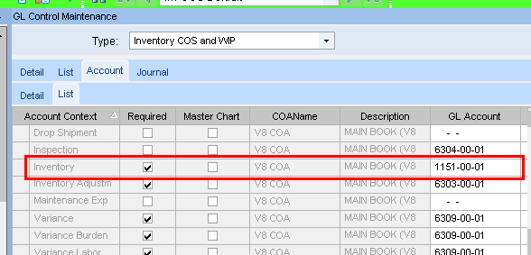

“Inventory COS and WIP” is GLC Type, that is used in the Company Configuration:
My GLC (Default for Type Inventory COS and WIP) looks like:
Note that the Acct for the context Inventory is entirely filled in (all three segments entered)
If I had no Division type GLC’s then every part tran that hits inventory would use Acct 1151-00-01. Regardless of the site.
The Division Type GLC’s specify just the Division segment (ex:____-11-__).
I’m pretty certain that the Divison GLC would replace the Div segment on any Account when the transaction happens at that site.
edit
I have no GLC’s specified on the Site Configuration window. Only specified on Site Maintenance

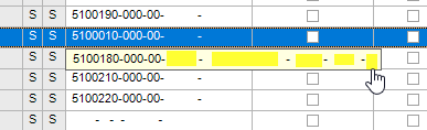

Hi,
Based on your info. I’m trying from this site _-010- Division also linked but after posting the invoice, we are getting the default what we selected in inventory cos wip .
After Posting AR Invoice GL hitting _-000- default site. not a correct division site.
Inventory COS -WIP
If you know why it is not coming let me know.
Are you using Dynamic GL Accts? Because the 2nd screen shot shows that the GL Acct structure has many more fields than you entered:
Maybe the Division GLC doesn’t work right with those?
