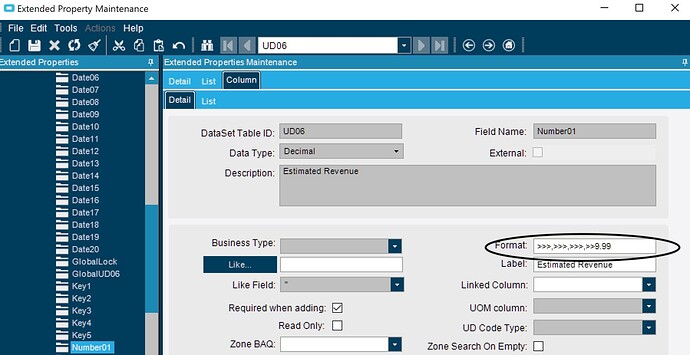

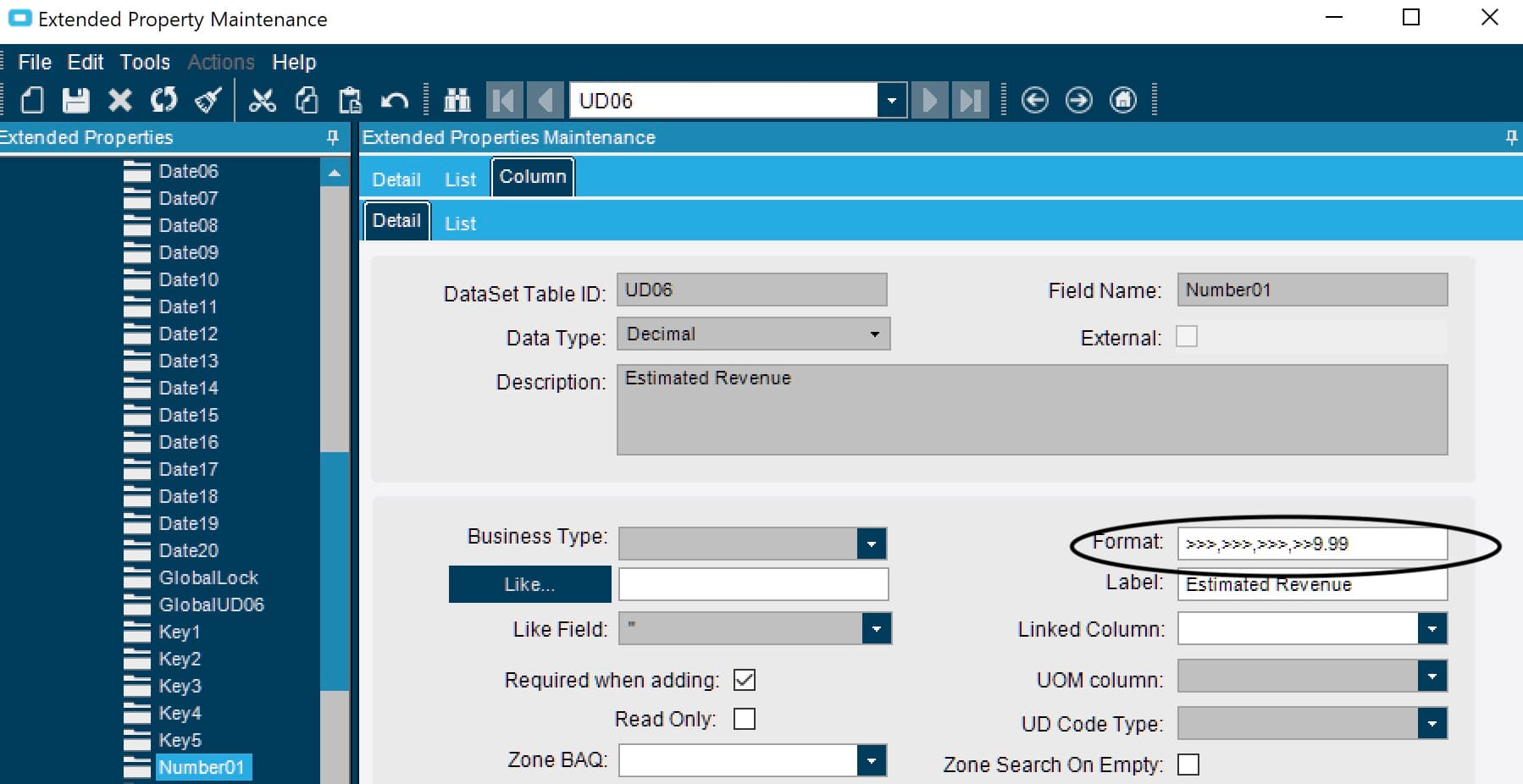

I tried changing the Extended properties as shown but then I got errors that I had to kill Epicor to get out of. Perhaps because there is data already in there?
Anyway, I still could use some advice on this.
