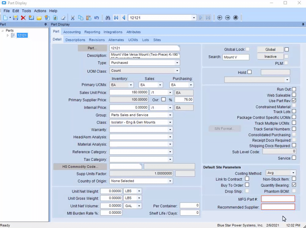

– Extended Properties
Set PrSupPrice_c to read only since its a copy of the SPL price and should not need manual edit
– Customization on Part Form
Added these items to match the Part_UD Columns that were added.

Calc used in mapping
queryRow.ttVendPart_BaseUnitPrice * ((queryRow.Part_SalesPricePer_c / 100) + 1)
