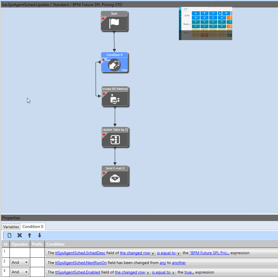

I’m stuck. I have a SysAgentSched.Update / In-Transaction BPM built as shown in their post.

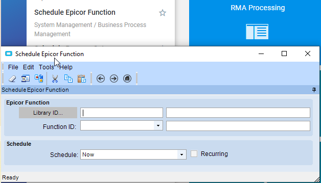

You can schedule a function to run a BPM.
I just did this for a customer on Wednesday and it works slick (easier than trying to attach to the system agent/monitor).
I was working on a 10.2.700 - so not sure if this is avail in 10.2.600. Search menu for schedule function. If you have it - you can figure it out in about an hour.

@kylepbsps - I’m glad my previous post could help. @DaveOlender is right - the newer versions that allow you schedule a function provide an alternate route - although I’d argue that using the schedule to trigger something is the same no matter how you do it :slight_smile:
As for you’re issue - I’d write the BPM so it work’s directly when you interact with the record - in order to test the code without having to trigger something that runs in the background that you cannot see. Get the code working in the UI as a BPM, and then move that code to the scheduled BPM or Function.

Alright! New toys! It does exist in 10.2.600.10 also
You have to start by allowing yourself permissions: Bring over the 3 Function Security Groups (Ok I brought over all 3 - you will want to research the abilities and limitations of each group and select just the appropriate security group - of coarse :slight_smile:

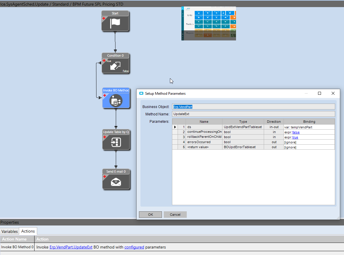

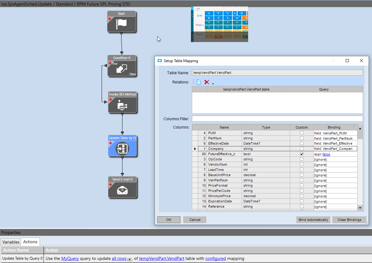

I can get this to launch on a schedule from the first post I referenced. I still cannot figure out how to update a UD field in the VendPart_UD.xxx only in the temptable which isnt useful.
I’m trying to clear a UD boolean field that meets certain criteria and run it daily.

I’m thinking Supplier Price List which access’s VendPart table rely’s on information from Part first. I’ll try to query part, then VendPart, or store my custom field in the Part Table, so I can retrieve it easier.
Simply would be
Query VendPart table where MyCustomUDField = True AND EffectiveDate = Today
Change field to False
Done
Trying to do this on a schedule to fire another BPM

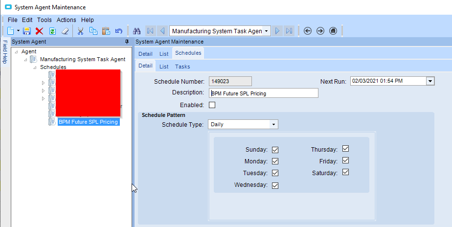

    7.Your BAQ/BPM is working as expected, lets schedule it. Go to System Setup > System Maintenance > System Agent. New > New Schedule.
  7. Once you have defined how often you would like this to run, lets queue it up. System Management > Business Activity Queries > BAQ Export Process
  8. Enter in your BAQID. Select Output Format CSV. Change the schedule dropdown to the one you create. CHECK RECURRING so it fires more than once on this schedule/frequency
