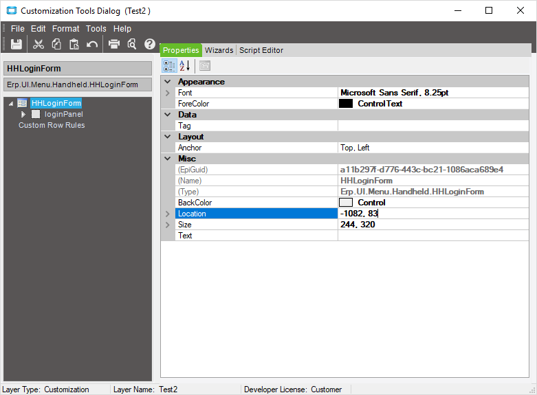

Trying to adjust the height of the login screen for the handheld and it keeps on reverting back to the original height even though I have update the menu with the correct customization.
Does anyone have any ideas?
I have been able to do it for other forms, haven’t tried it for the menu dialog yet, I suspect I might have the same issue.
@ckrusen
Sorry, I don’t quite follow? I know if I go into developer mode and select the customisation is shows correctly. If I add a different tittle to the form it shows outside of developer mode, but the screen stays the same…Pics to follow.
Oops. I should say I can change the Title and the height of the form in developer mode and save
Then when I log out of Epicor and back in and run I get the orginal form.
When I load the customization through developer mode I see the title but the height has reverted back
The Title shows, but the height has not changed.
I’m assuming I’m going to have to override the height property in the form Load?
I have to say I have seen a few posts around this and it is a bit confusing, Editing the sysconfig, changing scale, adding code etc. I have yet to see a concise document anywhere on this topic…or perhaps this is one of those buried in the Help
Or have you logged in? The application runs under your user account which at that point I thought would have logged in, because you are actually entering your employeeid which is linked to the userid…
Interestingly if you click ESC you still get the Epicor Handheld menu and then have to exit from there.
So turns out the guid on the form changes so customisations get lost. I think this also happens for the buttons on the menu form as well, I tried to change the size and location of the buttons and they reverted back to their orginal after saving and closing.

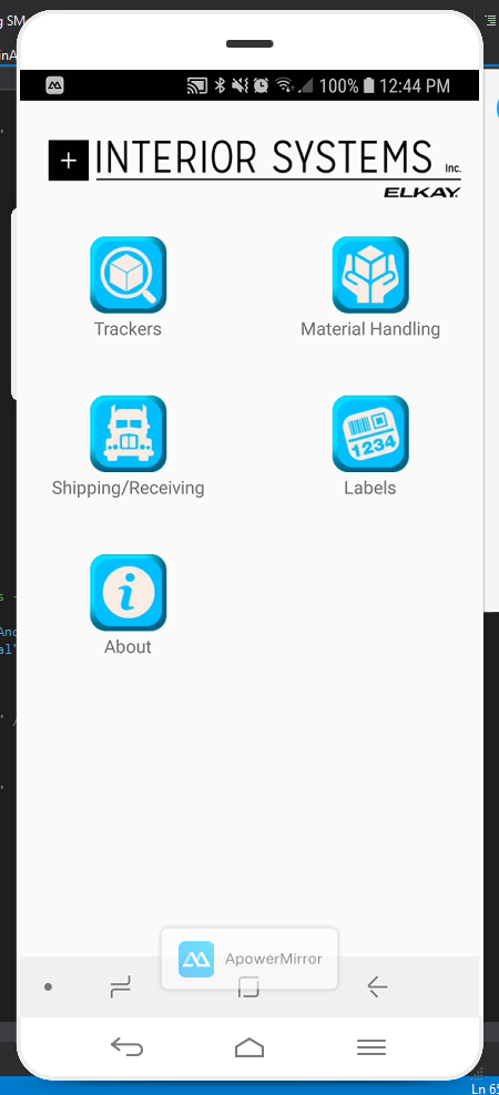

We (Bracalente Manufacturing Company) have been live with the BISCit android-based handheld solution for about a month now and are VERY happy with their product. It’s light years ahead of the stale Epicor handheld product. The company is very responsive. Happy to show/share the system with anyone who is interested. It works on 10.1.5 and above. We are on 10.1.6 going to 10.2.300
