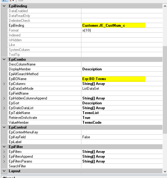

The following worked for me…
My test was to use UD field Customer.JE_Custnum_c to store an ID from Terms, using an epiCombo to display the Terms Description instead of the Terms code.
As you can see I left the Desc ColumnName property blank.
The only properties I changed for the Combo control were EpiBinding and EpiBOName. All the other properties were automatically set.
Also, my UD Column maintenance does not have anything in the Like fields.

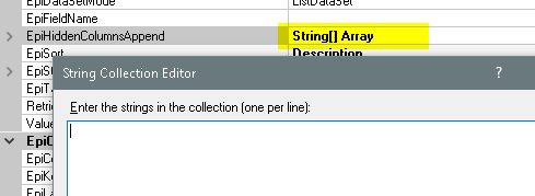

FWIW, here’s what’s in those other fields:
All 3 EpiFilter String[]Array’s are blank.
Thank you! Simply removing the DescColumnName seems to have fixed it.
