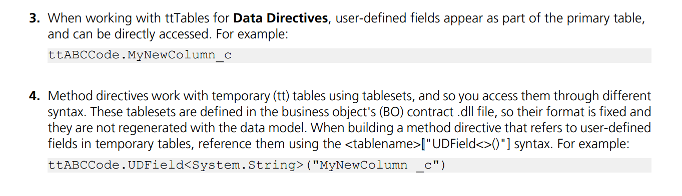

Just to clarify what @timshuwy said. This is true, but only in data directives. If using a method directive and accessing a tt ud field you must use something similar to what @Jason_Woods posted.
Here is the official Epicor verbiage - might be a little dated.
Dan,
I believe that’s true, but only with the tt tables. This is a reference to the Customer table, so Customer.CustShortName_c should work in both method and data directives.
