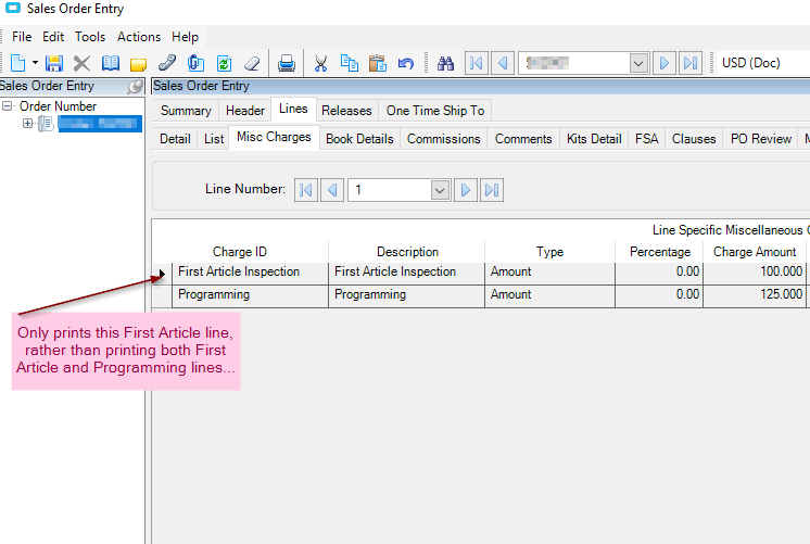

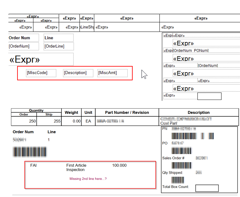

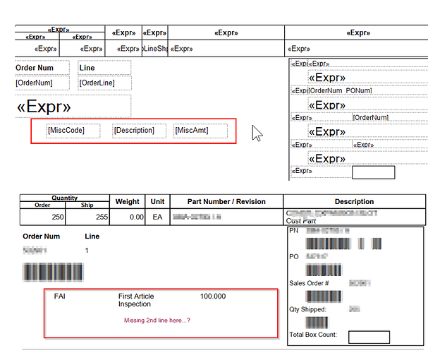

Thanks for the reply. So I have kind of halfway figured this out. I’ve got our misc charges to pull over (it pulls from OrderMisc per each line), but it only prints the first line of the Misc Charges.

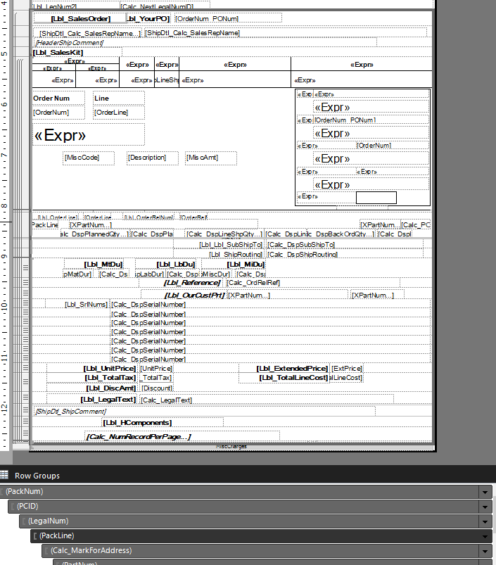

You would have to show your row groups. I am going to assume that you probably only have one or two row groups based on the images. It looks like it might be tough to do what you want where you want it.

There’s quite a few! let me know if you need a better picture

A subreport would work. To get the detail lines of the misc charges on your current report, you would have to move the fields to the PackLine row group. It appears it is in the PCID row group currently.
