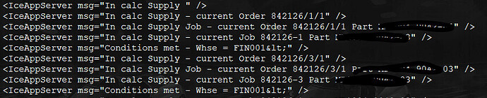

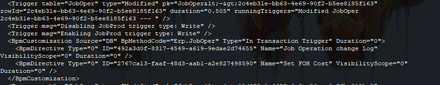

Is your serverlog in verbose mode?
I get details on Epicor triggers and then each bpm that run is listed so you see the bpm name just before the exception.

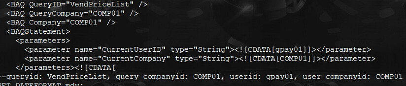

You are right it is not. I do get BAQ entries like below, but I don’t know if those get written if the BAQ fails.
This message you get when you enables
<add uri="profile://ice/fw/DynamicQuery/BaqStatement" />
trace flag. If TS version is accurate they probably don’t have it yet.
and yes, it is written for failed baq too.
