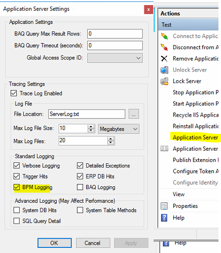

@cfinley I do a lot of logging of the start and exit of my bpms. These show in the serverlog and event viewer. Some like @Chris_Conn would maybe say it is excessive. there is a better way to do tracing that you can turn off and on as needed, but i have not had the time to get it setup.
If you are using the server log and have bpms checked then the bpm would be listed just before the error.

@cfinley I am talking about the setting on the appserver(s) that is here. In your inetpub\wwwroot\AppServerName\Server folder will create a series of ServerLog.txt files.
EDIT:
Also has client and server and user info.
