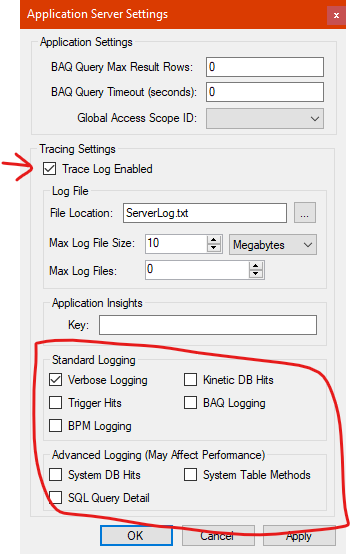

I tried switching on all the options in the application server settings gui under ‘tracing settings’
Can you share a screenshot of those settings? I usually do it manually so I don’t know if the GUI shows the same or not.
the opitions I mentioned are in AppServer,config in server folder, they are not in GUI.
