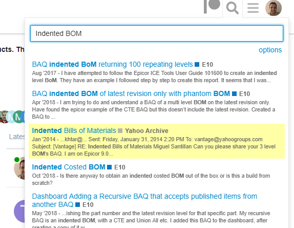

The Epicor BAQ Help has a walk through on how to build an indented BOM using a CTE. Also there are a LOT of posts on this forum which talk about / tackle this problem. Have you checked those out yet?
