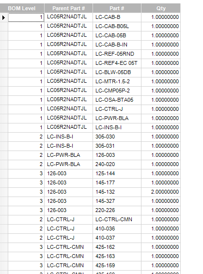

Right now, I have a query that will return all parts under a top level, assign them a BOM level, and show me the parent part and the current part. For the life of me, I can not figure out how to sort it so that my child part goes under the parent part in this table. I have tried doing a calculated field that creates an ID of every part going down the list, incorporating its parent’s calculated field as well, but I can’t get it to work and I feel like there has to be an easier way.
Here is my current query results:

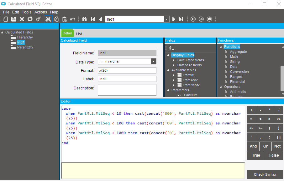

I’ve done this with a calculated field. I use the material sequence number in the PartMtl table and create something like Parent Seq - Child Seq. Then I sort by that calculated field. Here’s what I did. In my CTE subquery, the sequence (Ind1) is like this.

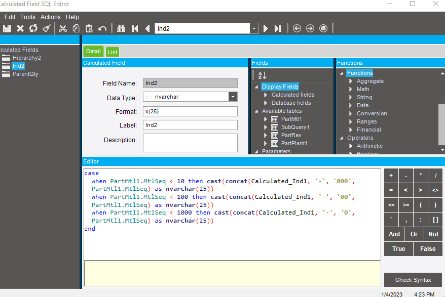

Then I do the lower level sequence (Ind2) like this:

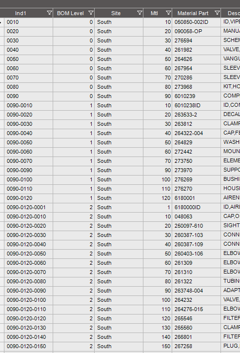

It makes something that looks like this:

Actually, this is exactly what I was looking for! Just couldn’t figure out a way to do this and sort properly. As long as it take its parent “ID”, and adds it’s own, it sorts. Thanks so much, you’re a lifesaver!!
