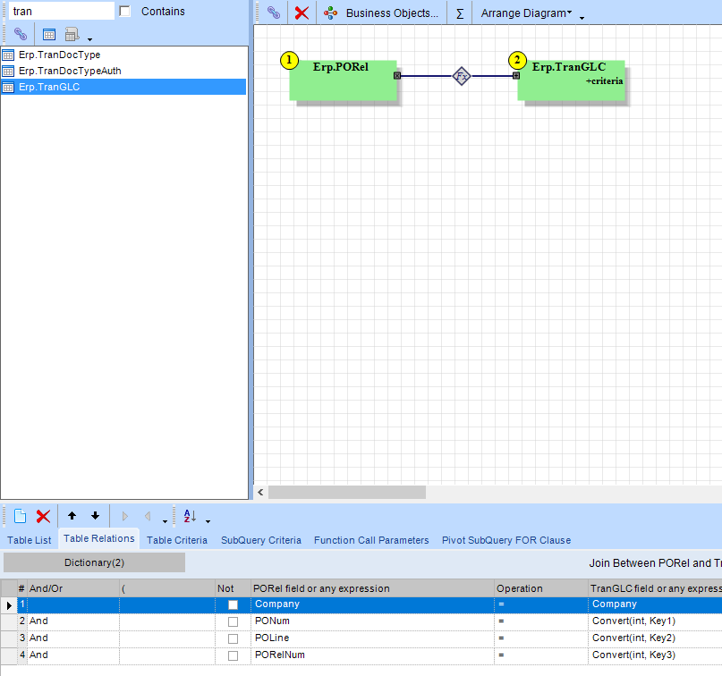

What I need to to link the two tables in RDD so I can use the GLAccount field on the SSRS report when printing the Purchase Order.
I tried what you showed on the Relationships tab in RDD and it didn’t take it.
Any ideas on how to do it in RDD or writing a BPM that copies the TranGLC.GLAccount field to a UD @ PORel.GLAccount_c?

You can’t do it in RDD bpm is the only way I know. :confounded:
You would also need to include The RelatedToFile field in your join to limit the records to those where the RelatedToFile =‘PORel’
I have not tried this in an RDD, but the join relationship between TranGLC and PORel in the straight SQL Syntax is something like this:
select top 10 POR.PONum, POR.POLine,POR.PORelNum,TGL.GLAccount
from erp.tranglc TGL with (nolock)
inner join ERP.PORel POR with (nolock) on (TGL.Company = POR.Company and TGL.Key1 = POR.PONum and TGL.Key2 = POR.POLine and TGL.Key3 = POR.PORelNum and TGL.RelatedToFile=‘PORel’)
Hello @frontierits,
That was the join I attempted but didn’t work. The key fields are strings and the PONum, POLine, and PORelNum are integers.
After I tried a couple of different things with that, I figured that wasn’t going to be my answer. But I asked anyways in case I was wrong.

If this is related to your other post. Think you can do this in the RDD. Please post your expression.
This might help. The string value needs to be in a cast statement.
Select *
from Erp.TranGLC glc
inner join PORel po on glc.Key1 = cast(po.PONum as varchar)
and glc.Key2 = cast(po.POLine as varchar)
and glc.Key3 = cast(po.PORelNum as varchar)
and glc.RelatedToFile = ‘PORel’
