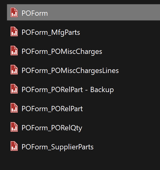

I can’t access the PORel table in the sub SSRS report from the main report file, POForm.
How do I add the table to the main POForm SSRS report so I can put the dropship address in the Ship To field?

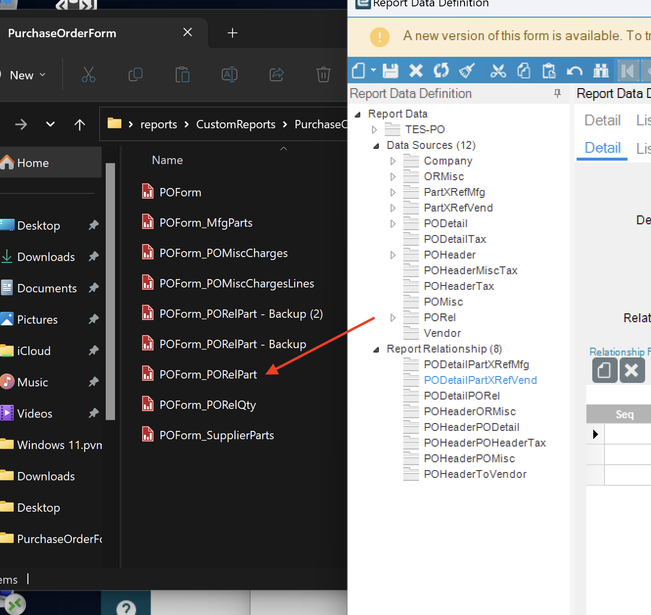

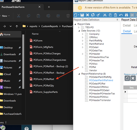

The PORel table is part of the POForm RDD. If the fields are not available, all you have to do is include them in the RDD, add them to the report query, and add the fields.
I think my hangup is my inexperience with RDD and SSRS. I see PORel in my data definition. So that is there.
I don’t fully understand calculated fields. Seems like you’re adding a place holder field and then in SSRS you add the SQL in the Expression field/window. Unless there is a way to make calculated fields inside of Epicor?
Currently the standard ship to address is a calculated field. I added a calculated field in the RDD for the dropship address. Unsure how to link the data to that calculated field, unless it must be done inside of the SSRS report.
I still haven’t figured out how I can pull in/link the data from PORel into the main POForm report. Tried using the fields for the dropship data found in the PORel SSRS report, inside the POForm (main report) and it errors out. I would think it’s simple but I’m not seeing it.
Example… I don’t know how the data is mapped from the RDD to the SSRS. Watched a video or two but they never explained that.
