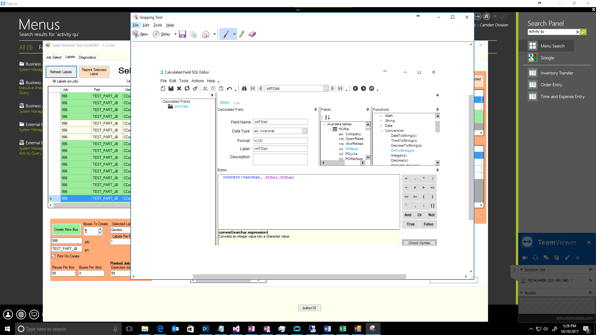

On subquery, you’d get your int value and cast it to string with a calculated field.
Then bring in the subquery and use the string field to compare. @knash is the BAQ guy, I bet you can butter him up and he’ll drop screenshots :slight_smile:
Simple example of using calculated field to cast an int (PoNum) to a string. I’d filter that to get only the needed record.

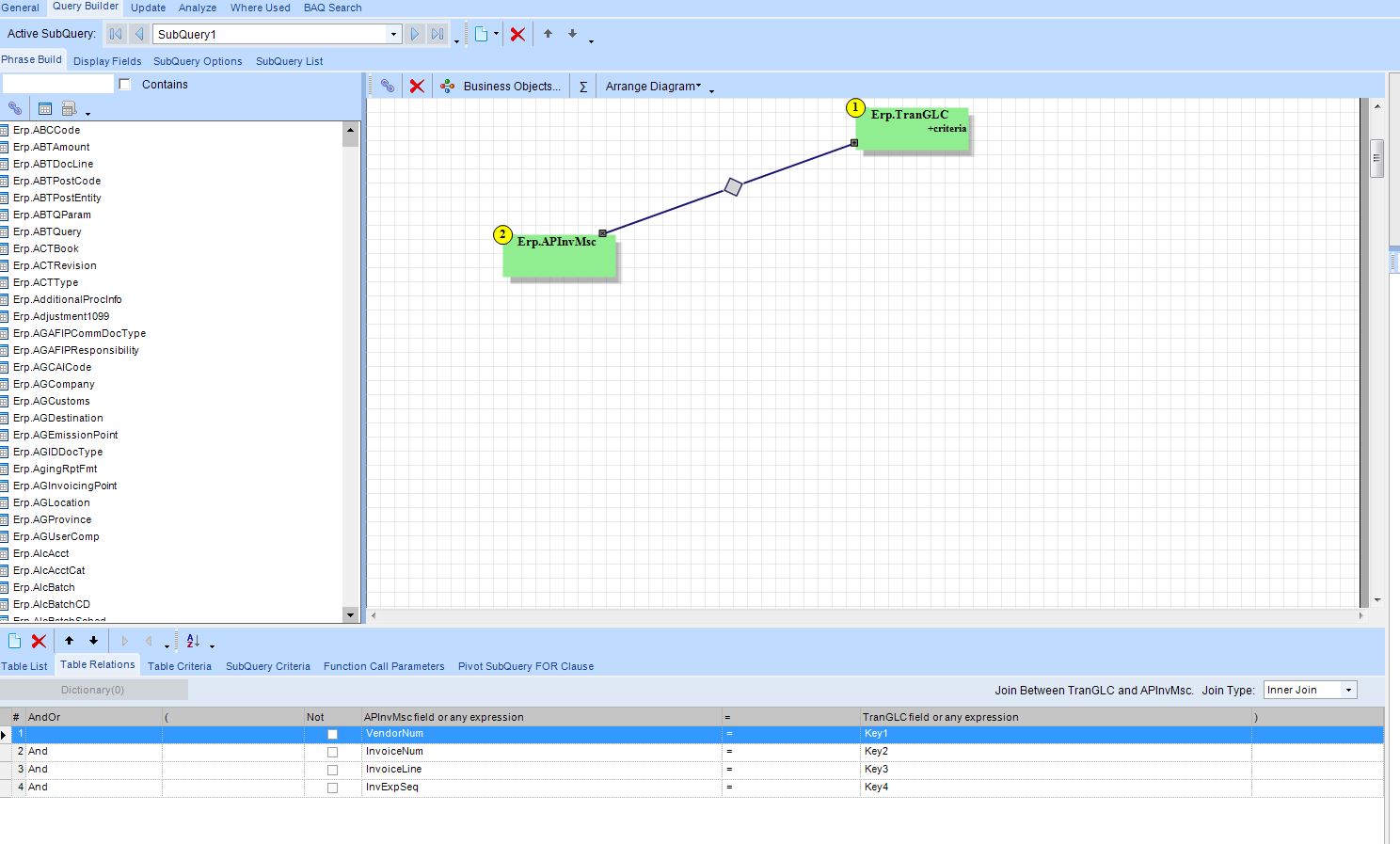

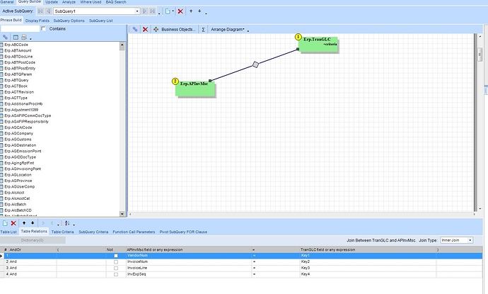

Don’t be so crazy Chris. You can just join the fields. Epicor Magic takes care of the rest. Different Table but same concept. The VendorNum, Invoice Line, and InvExpSeq are all INTS.
In that case - I reclaim this post in the name of science. Who knew Epicor was so fancy :slight_smile:
lol I saw the post and was laughing. I should have taken a screen shot.
