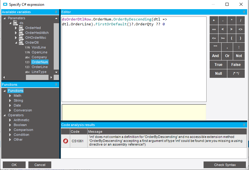

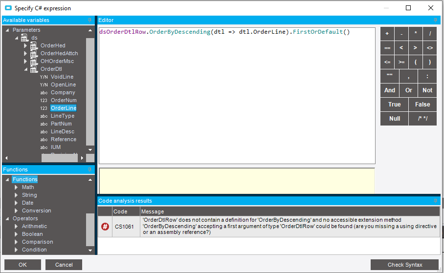

Is anyone out there tonight that can help me with this syntax? It works on the ttOrderDtl but not the dsOrderDtlRow
i think you are wanting dsOrderDtlRow.OrderByDescending(dtl => dtl.OrderLine).FirstOrDefault()

Oh thats a single record, theres nothing to order.
From working on this BPM I know there is 9 records in it and when using the temp tables with the help of others I got the code to not fuss. Unfortunately the data I need is in the dataset called dsOrderdtlRow and the field is called ordernum. I am sure it is simple but I just don’t have the knowledge to find the correct syntax.
If I just set this to dsOrderDtlRow.Ordernum in the BPM when it runs I have a messagebox to show me what it gets. It responds with a message that multiple rows exist.
