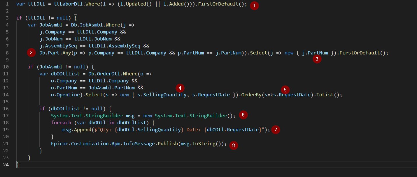

Sorry, but I am on a little bit of a rant on making BPMs as efficient as possible.
This BPM actually shouldn’t take too long as it was originally written, BUT, there are some efficiencies that can be gained. So (sorry again), I took the BPM and refactored… below is a screenshot with bullets, and what I did to make it different. Most of what I did was reduce the volume of data that is returned by each query. In one case, I completely eliminated a query.
I have been spending time the past few weeks refactoring many BPMs that were consuming unnecessary CPU time retrieving unnecessary data, or doing extra queries… so this is all very fresh in my mind.
I also converted all the queries to Lambda expressions, because personally, i find these more readable.
  1. Simplified tt table query (dont need to look for company here)
  2. merged two queries together, including an “Any” query for the part, since it was only looking to see if a part exists in the part table. This ANY query eliminates the data payload being returned for the part number
  3. only selecting the one field required for this BPM (reduced data payload)
  4. only selecting the two fields required for this BPM (reduced data payload)
  5. the OrderBy that you were asking about
  6. change the building of your string to a “String Builder” which is more efficient on memory.
  7. Rebuilt how to build the string using the $" function
  8. No need to have an if statement, because we are already inside an if condition.

One potential improvement would be to combine the JobAsmbl and OrderDtl queries into one joined query.
var ttLDtl = ttLaborDtl.Where(l => (l.Updated() || l.Added())).FirstOrDefault();
if (ttLDtl != null) {
    var JobAsmbl = Db.JobAsmbl.Where(j =>
        j.Company == ttLDtl.Company &&
        j.JobNum == ttLDtl.JobNum &&
        j.AssemblySeq == ttLDtl.AssemblySeq &&
        Db.Part.Any(p => p.Company == ttLDtl.Company && p.PartNum == j.PartNum)).Select(j => new { j.PartNum }).FirstOrDefault();
    if (JobAsmbl != null) {
        var dbODtlList = Db.OrderDtl.Where(o =>
            o.Company == ttLDtl.Company &&
            o.PartNum == JobAsmbl.PartNum &&
            o.OpenLine).Select(s => new { s.SellingQuantity, s.RequestDate }).OrderBy(s=>s.RequestDate).ToList();
        if (dbODtlList != null) {
            System.Text.StringBuilder msg = new System.Text.StringBuilder();
            foreach (var dbODtl in dbODtlList) {
                msg.AppendLine($"Qty: {dbODtl.SellingQuantity} Date: {dbODtl.RequestDate}");
            Epicor.Customization.Bpm.InfoMessage.Publish(msg.ToString());
