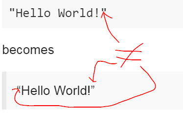

And if the source text used in a copy and paste is from a word doc, email, or website (including this one), quotation marks will be replaced with fancy ones.
"Hello World!"
becomes
“Hello World!”
