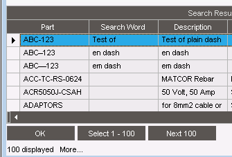

Well, I just did a test. Each of the following P/N’s can coexist in the Part Master
ABC-123 “dash” (ASCII 45)
ABC–123 “en dash” (ASCII 150)
ABC—123 “em dash” (ASCII 151)

Those are technically different part numbers, you could probably write a BPM to remove any non std character or raise an exception… using some fancy bit of RegEx
I apologize for not completely understanding, but the answer I gave holds true. Epicor does treat them as seen. So if there’s a difference between part numbers Epicor will see it and treat it accordingly. In this case Epicor treats it as a different part number.
I think you were hoping Epicor would give an error saying, “Duplicate Found”. You can write a BPM that do that for you.
