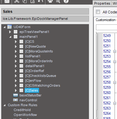

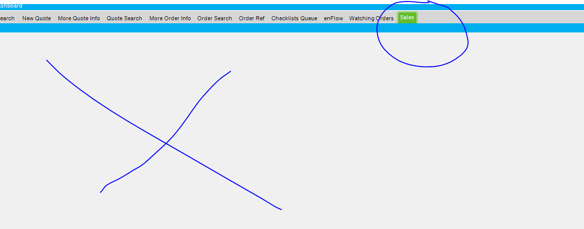

I am trying to hide a tab and everything that is on it. So far, only the stuff on the tab is hiding and it is leaving the actual tab…
Sales is the name of the tab.
Sales.Visible = false;

If it is the right name, maybe hide it’s container.? Maybe you hid the wrong panel from the left side list of panels?
Can you hide /unhide not via code but by selecting it and change the visible property?

I changed it to this and it is still not hiding the actual tab:
			Ice.Lib.Framework.EpiDockManagerPanel SalesPersonPanel = (Ice.Lib.Framework.EpiDockManagerPanel)csm.GetNativeControlReference("501d683b-5674-4366-82f6-4d47dd91fe5f");
			SalesPersonPanel.Visible = false;

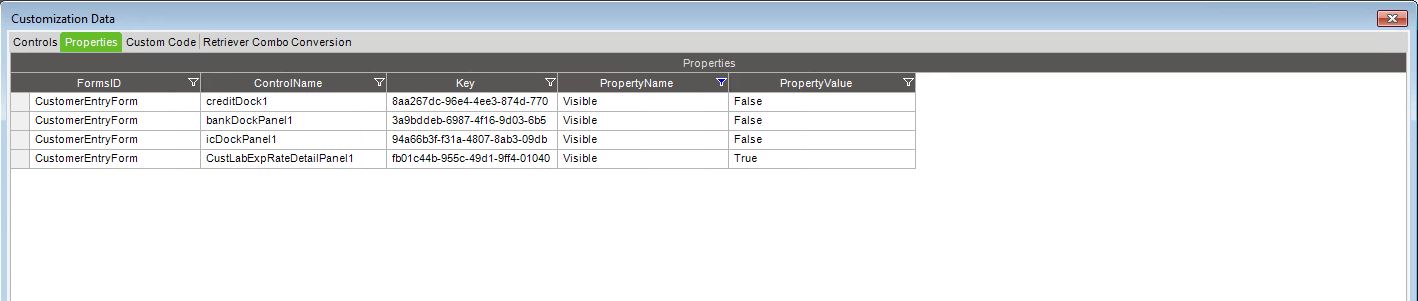

I’m not sure if it’s recommended or not but I have gone into Customization Maintenance and opened “Show Custom data”. If I try to set a property and it isn’t sticking sometimes it shows here and I can change the value. I had a tab I could not make visible after hiding it and I was able to fix it here.
