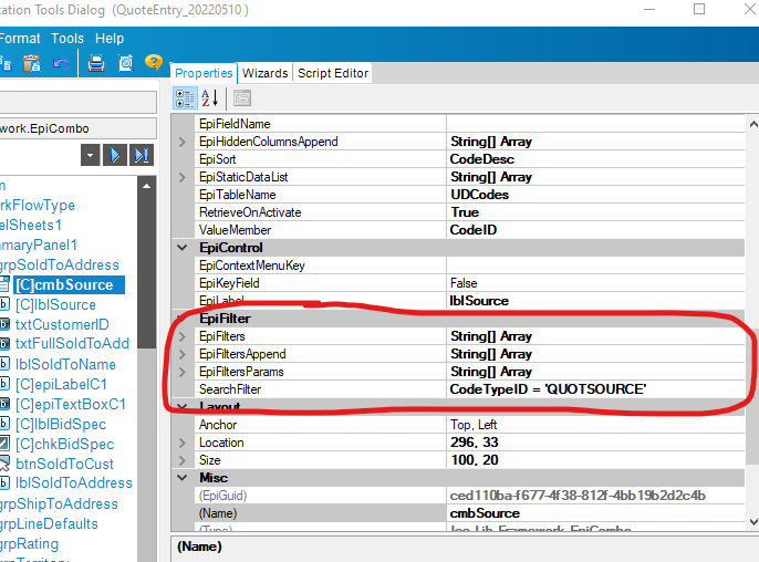

Have you tried using a search Filter?
Of course I tried using a search filter… What’s a search filter?
Edit: Oh got it, I don’t think that’s available on an UltraCombo?
I’m not sure if it would be available or would work on an existing form control. But this is what I was talking about…
I’m playing with it now to see if I can get it to filter using a like or contains statement
As far as I can tell, those EpiFilter options only appear for EpiCombos not EpiUltraCombos. I suppose I could try replacing the control…
