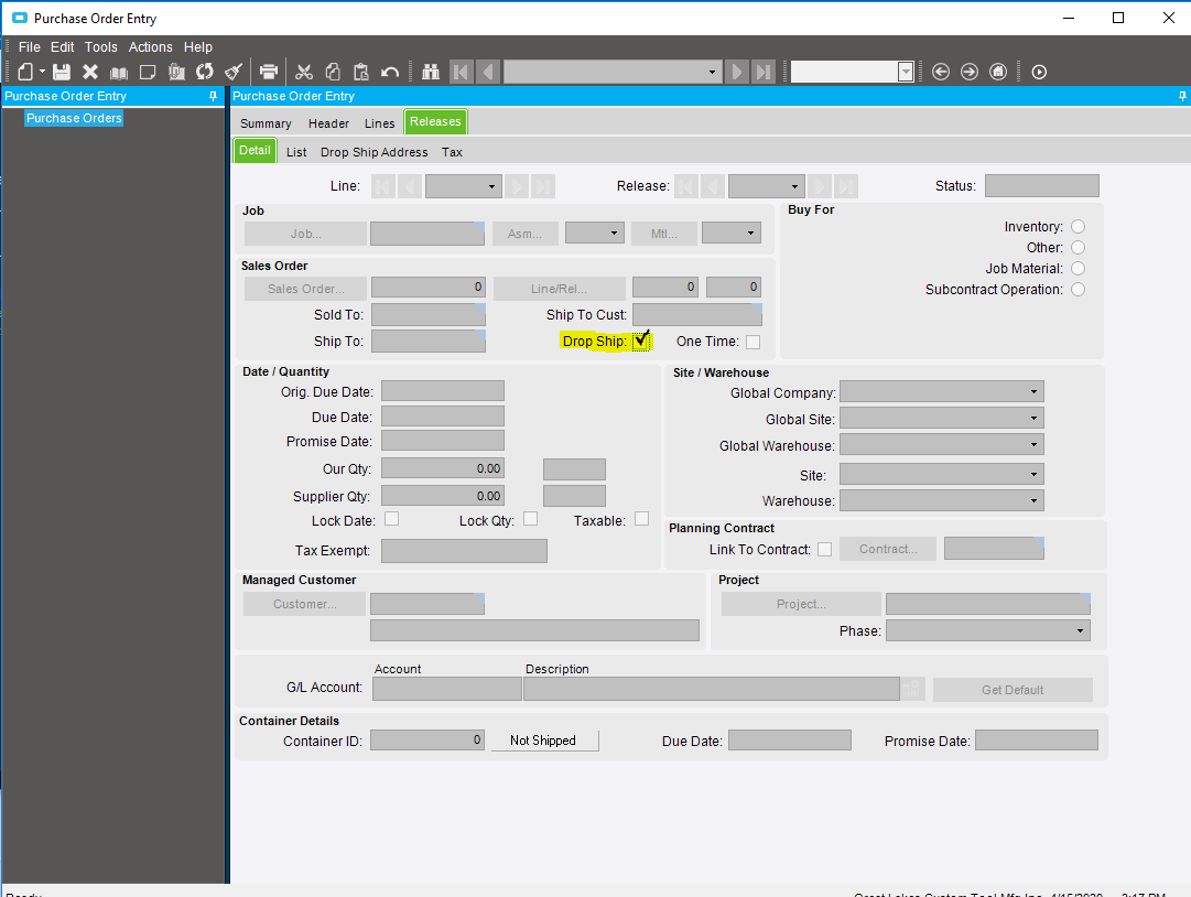

We would like the text “Drop Ship” to have a highlighted background when the checkbox is checked. Is this possible without too much custom code?

We don’t really care if the checkbox or the text changes red. We just want it more noticeable for staff. Any help on what can be done to make it more obvious when checked?
Add a group object, and make it parent of your checkbox, and it’s label. For the new group, disable to use Epicor theme… (sorry I am at home, not sure of exact terms) because I think you are not able to change it’s color otherwise…
that should work… I use this method to distinguish between sites for the sales order entry…I have a specific color for each.

You could just put a yellow rectangle behind it, and change the rectangle’s visibility in code.
This is super new to me… any guidance or an example on how to change that in code?

Sorry - I took a second look and since that is the standard DropShip checkbox you are kind of out of luck for using the row rule. I can post a code snippet later on how you can do this using your label and a bit of custom code
Thanks. A code snippet would really help. I’ve tried with row rules and some examples from other semi-related posts, but couldn’t get anywhere.
