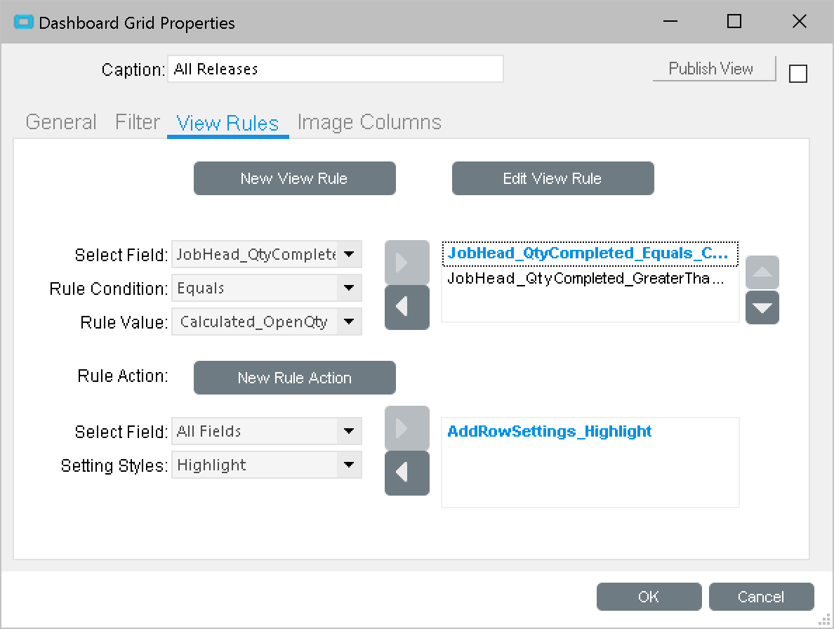

I’m trying to highlight rows of a dashboard grid different colors. There are tips in this forum regarding this topic, but I cannot seem to figure out exactly how to do it.
I created a BAQ and added it to a dashboard. In the grid properties of the dashboard query, I created a rule when the job completed quantity is >= order quantity, then highlight the All field. This works, but it does not let me choose a color. What am I missing in order to specify what color I want the row to be?

Right, I believe you need to do it in the Customization layer to pick any color you want. Without a Customization I think you can only choose red, yellow, or green – which correspond to “error”, “warning”, and “ok”.
