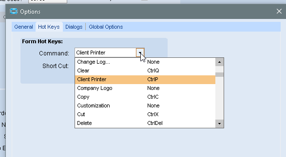

There is a Hot Key Command specific to Client Printing…
Where is this at? In Customer Shipment Entry–>Tools–>Options that is not there.

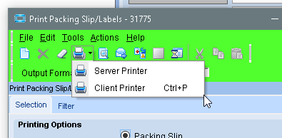

Its on the Print Window
then…

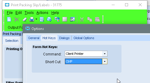

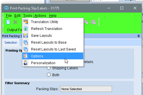

So you’d need to setup two hot keys. One on the Cust Shipment form (just to launch the Print window), and the second in the “Print Packing Slip/Labels - …” form, to act like selecting the Print Icon dropdown.
The second gets you:
