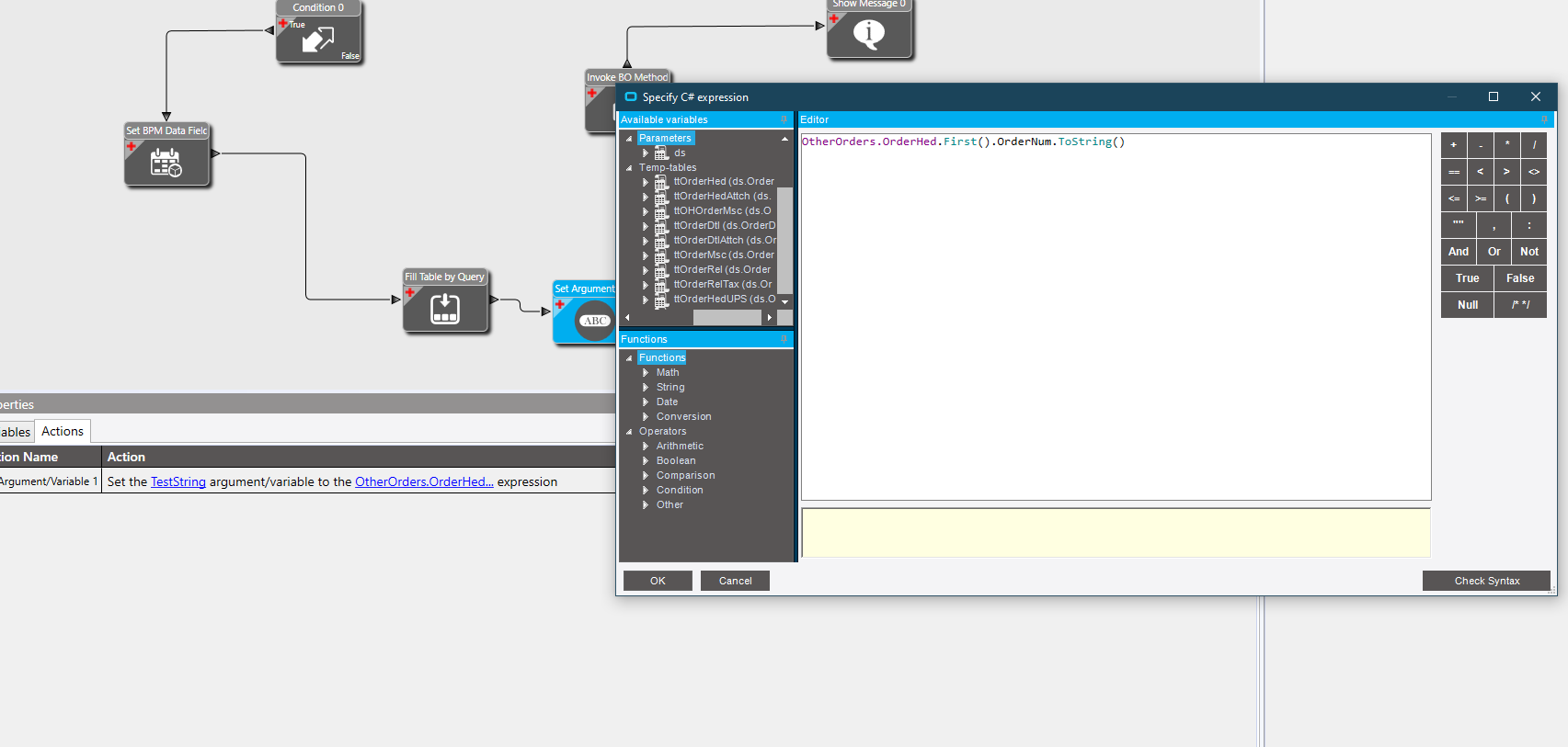

Now I want to make a BPM such that if order 8005 is closed/deleted/etc then 8011 becomes the new parent. At first I figured it would be easy, just take the first row of the query where ShortChar02 = 8005 to get the new parent number, and then use fill table to update them all to 8011.
I can’t figure out how to get the first result, would be so easy if I could use LINQ or probably even if I could use the full BAQ options, but the BPM query options are so limited.
Is there any way to do this with the darn blocks?
I think I might have found a way, you can slip in little bits of code with the set variable block like so:
Very nice solution.
