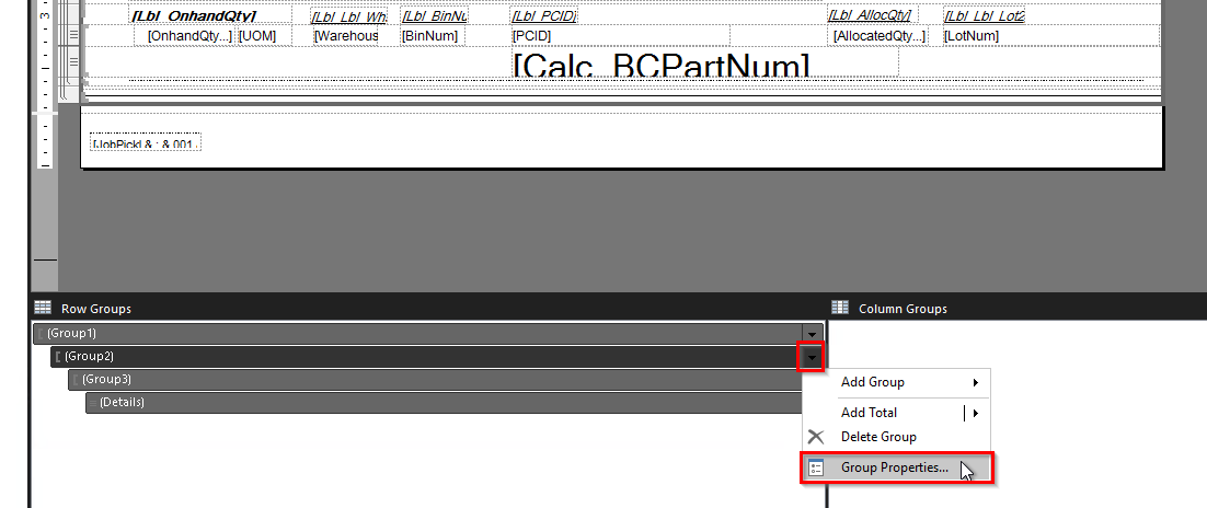

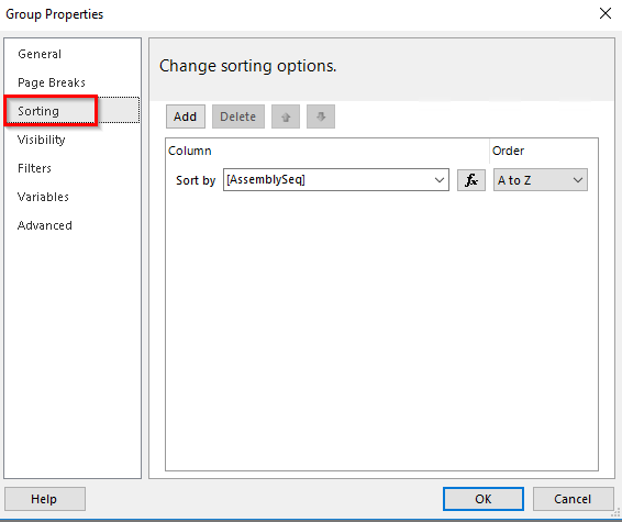

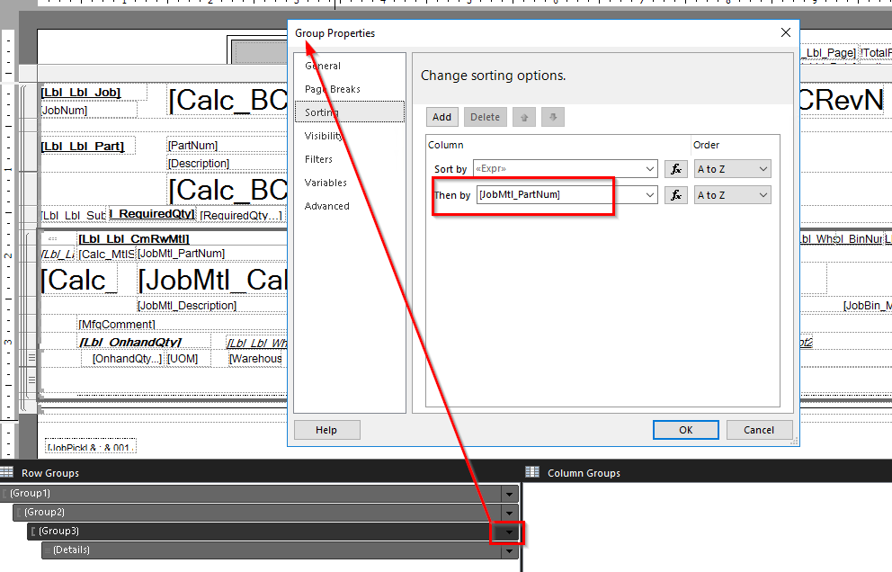

See the Sort in the group properties (you’ll have to figure out which group you need):

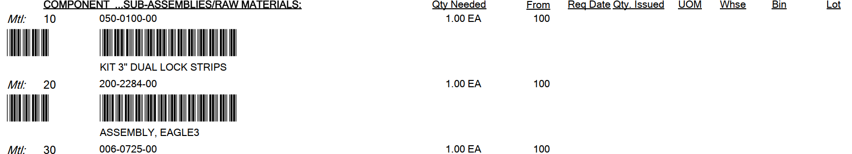

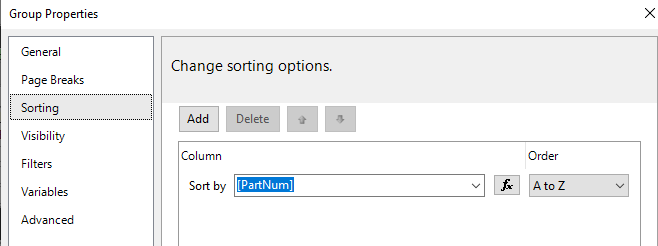

Hello,
That was the first thing I tried.
I changed every one of the groups sorting to PartNum. It still printed out in the same order as before.
I even changed a color on the title to make sure my changes were uploading. They are.
Any ideas?

That is not the correct field. [PartNum] is the finished good, you need the materials - [JobMtl_PartNum]

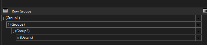

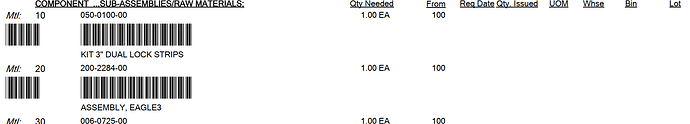

Hello,
That seemed to be part of the key but I finally got it working (as far as I can tell) by a combination of changing/deleting grouping in the groups and changing the sorting in the groups.
Group Detail: I deleted the group ‘Details’ leaving the columns intact.
Group 3: I deleted the grouping. I changed the sorting to be only ‘JobMtl_PartNum’.
Group 2: I changed the grouping to ‘JobNum’ and deleted all sorting.
Group 1: I left alone.
After I did this, it gave me all the lines grouped by Jobs and sorted by PartNum.
I am explaining what I did for any future person who wanted to do this.
Thank you all for the help!
