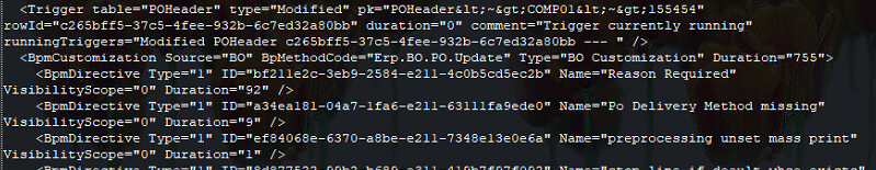

@shobdy To your original question. If you turn on server logging and check bpm logging then all of the bpms that fire during that process will be listed.
Serverlog
