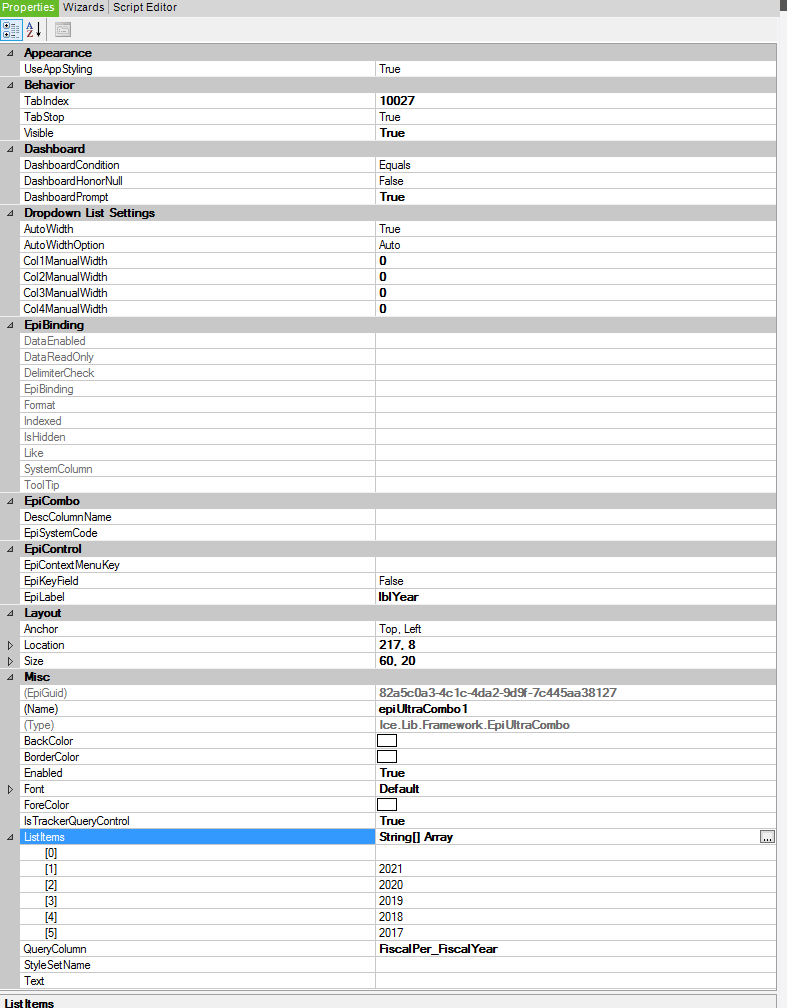

Then within the Customization Tools Dialog, select EpiCombo and place it in the body of the tracker. Then in the control properties, set them like this:
Once you set the IsTrackerQueryControl to true, you can select the QueryColumn you want linked to the tracker. In your case, it would be the company site, but don’t forget to return that column in the dashboard query, otherwise the tracker won’t know what to look for. In the ListItems, you can manually key in the available values, leaving the first line blank so that selecting it can return all rows. Set DashboardHonorNull to False also to enable that option.

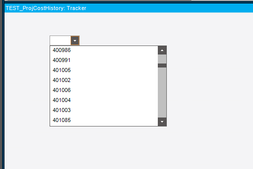

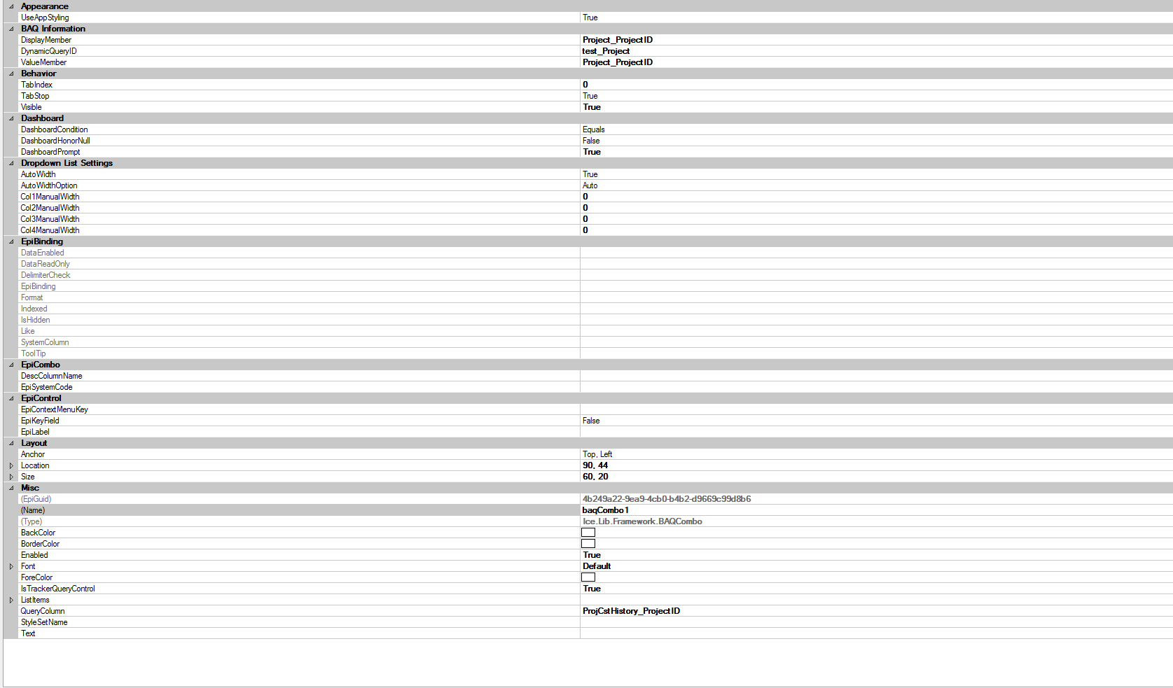

For that, you’ll have to use a BAQCombo. Here’s an example I made up just now:
My grid is basically just the Project Cost History table, but I want to search by ProjectID from the Project table. To do that, I have the “test_Project” BAQ which returns the ProjectID column, and I link the BAQ in the DynamicQueryID property. The DisplayMember and ValueMember are what literally shows in the drop-down and the corresponding search value, respectively. Set DashboardPrompt to True, then at the bottom of the properties, set IsTrackerQueryControl to True, and set the QueryColumn to the target column in the dashboard grid.
When you save, you’ll get something like this:
Of course, there’s nothing stopping me from using the same query in the BAQ combo as in the dashboard grid, just to have fewer BAQs to keep track of.
