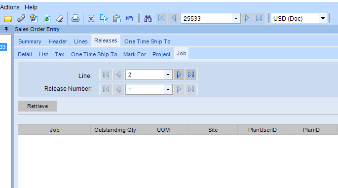

How do you assign a job back to an order line release?
If a user deletes a job that is assigned to a line release, is there any way to assign the same job back to the release?

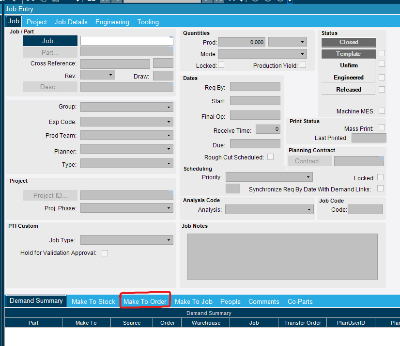

Open Job Entry and bring up the job. Check the Demand Summary. If the Demand link has been deleted for Make To Order, you can add a new one there. This will link the job back to the Sales Order:
