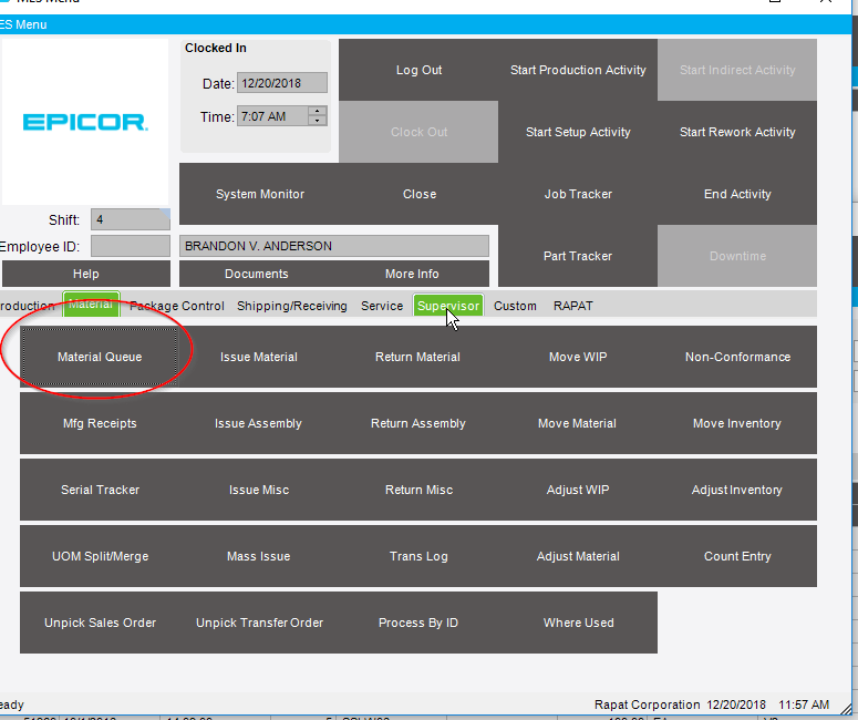

go into your material que (you have to do it from MES) and find the record and delete it.
Had no idea! Thanks!
