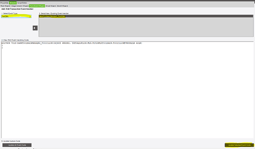

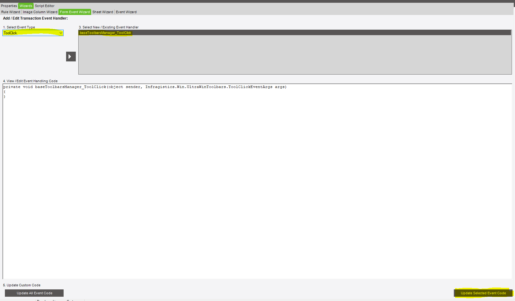

Here’s what I did after getting into customization mode:
Added ToolClick function with form event wizard (BeforeToolClick didn’t work surprisingly)

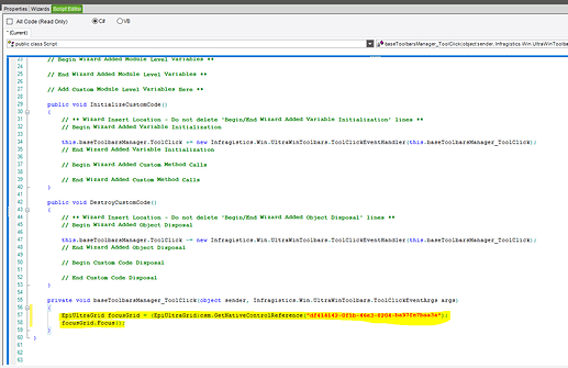

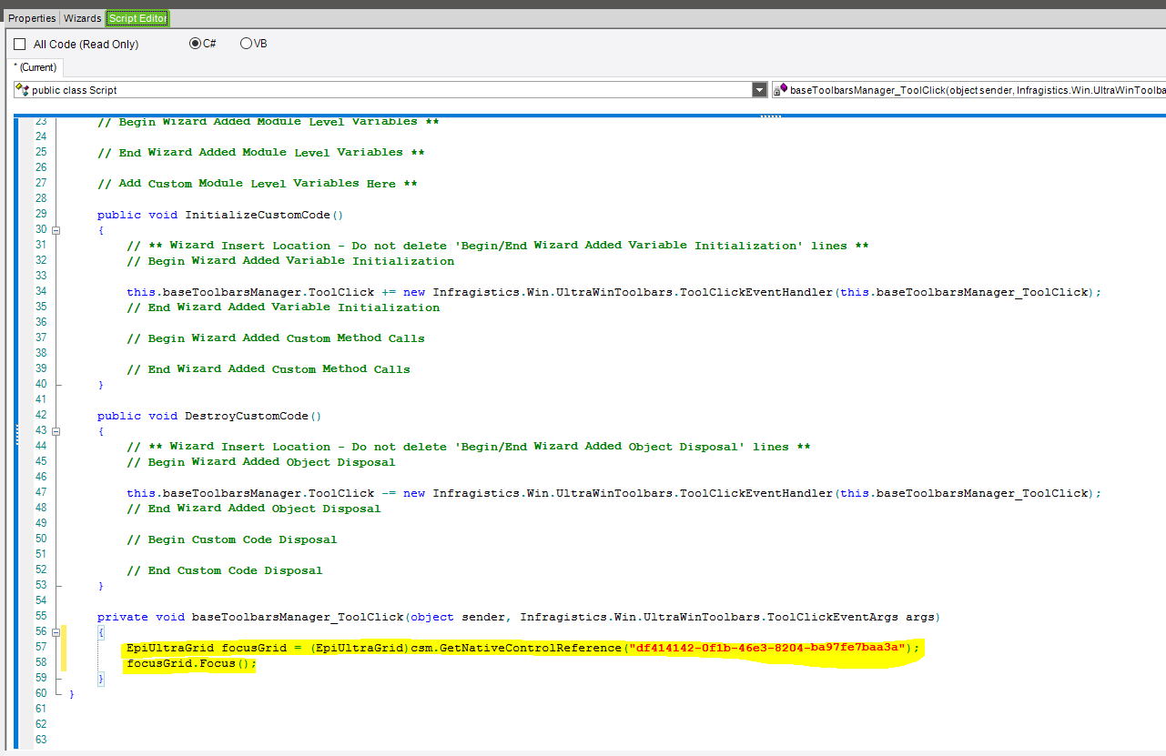

Added the code to focus grid to the newly generated function

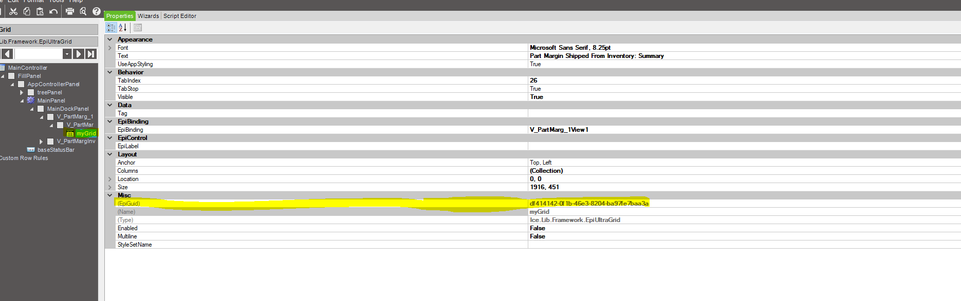

EpiUltraGrid focusGrid = (EpiUltraGrid)csm.GetNativeControlReference("df414142-0f1b-46e3-8204-ba97fe7baa3a");
focusGrid.Focus();
You’ll need to change the EpiGUID to match your grid’s. You can find it in the grid’s properties.
