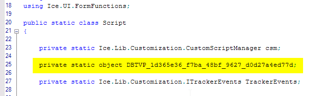

Which I figured I could just do within that LostFocus event of the tracker’s field.
But my dashboard (an Updateable one) doesn’t reference a “DBTVP_…” anywhere (yes I checked the All Code checkbox).

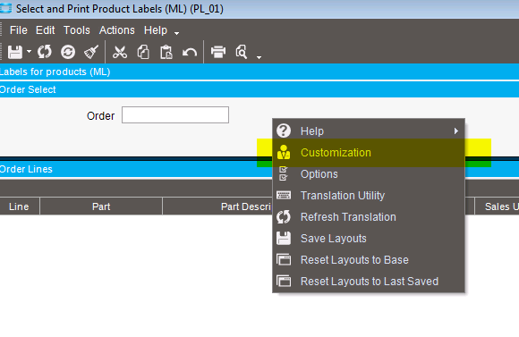

Wait a minute - is there a refresh button or toolbar item?

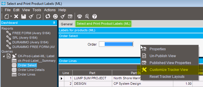

I think I figured out the problem. Since it’s a deployed Updatable dashboard, right clicking and selecting “Customization”,
isn’t the same as opening up the dashboard, enabling developer mode, and right-click select “Customize Tracker View”
Doing the later shows the reference I need.
But now I realize all the changes I made customizing the deployed Update-able Dashboard, must be re-done in the base dashboard. :frowning:
A bitter sweet victory :persevere:
