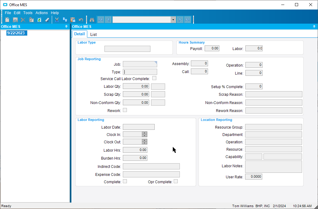

OK, I’m in, but all the fields are greyed out. New and Search are not available.
When I launch MES, it launches as its own application, I’m prompted for an employee number, and off I go. Apparently not so with Office MES.
I believe you have to use the Actions menu to navigate this. It will be different than your standard MES but I believe it can function similarly. Ive only used it in limited scenario’s so I am not an expert in this case.
It needs your login ID to be linked to an EmployeeID… there are areas in both User Account Security Maintenance and Employee to create that link.
