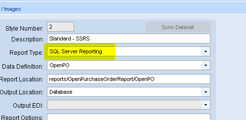

When you say “old crystal report”, you just mean it’s the one Epicor supplies? (which is actually a SSRS report).
Or is it really a crystal report? To be sure, go to Report Style Maint and check the Report Type for the style you’re using.
You should copy the report style (select the style to duplicate, then Actions -> Copy Report Style on the menubar). Then you can make changes to the newly created RDL, without affecting the original.
In the new RDL, add a grouping on the Buyer. And it will always group by the Buyers regardless of which sort style is selected. If you want to make that grouping optional, you could add a checkbox to the form, and pass its value via a callcontext variable.
Looking at the Report Style Maintenance, I do see the Standard style is an SSRS, however, there are 3 additional style definitions that are of Report Type Crystal. This is because this system I’m working on was recently converted from E9 to E10 and they were using Crystal Reports in E9. These were not converted to SSRS before converting to E10. So … I’ve been told to disregard the Crystal reports and only focus on the Standard report for right now.

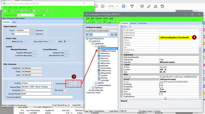

  1. Customize the form that runs the report, by launching in developer mode.
  2. Enter customization mode
  3. Add the control to hold the variable (textbox, checkbox, combo, etc…)
  4. Bind that control to a CallContextBpmData member
  5. Save Cutomization and close

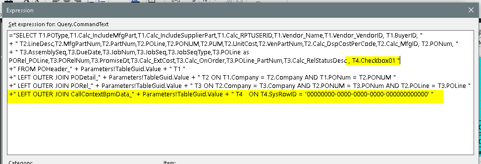

  10. Edit the main dataset’s query expression. Adding the field to the select phrase, and a new join phrase. In my example (the OpenPO report), the PoHeader dataset is the main one. So in its query expression, I add the highlighted parts:
    I choose T4 as it was the next available “T#”

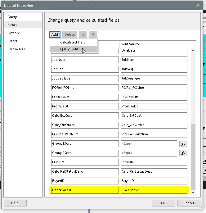

  11. Add the query field:
    (You can give it a better name if you’d like).

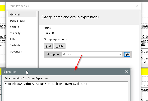

Now I can use that checkbox’s value in my report. For example, to enable a grouping
  1. Save the Report RDL
  2. Upload to server (via Report Style Maint.)

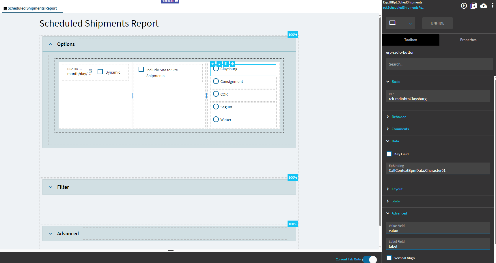

Does this work in Kinetic Public Cloud? I’ve been trying to replicate this in the Scheduled Shipments report with no luck. I created 5 radio buttons on the Scheduled Shipments Report screen, set them all to the CallContextBpmData.Character01 field for the EpBinding, added the LEFT OUTER JOIN onto the SSRS OMR50 Dataset query (per your instructions), and added the field T6.Character01 to the Query Fields and the main report. I am unable to get the value to show up and if I try changing the LEFT OUTER JOIN → ON value to anything else (e.g. T1.Company = T6.Company), it then errors the report on the OMR50 dataset. Any help on this would be greatly appreciated.

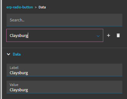

Here are screenshots of my screen customization:
Each radio button has a different ID and Data values, but they are all set to the CallContextBpmData.Character01 EpBinding.
I’m pulling my hair out trying to figure out what I’m doing wrong…all while hoping it is just something stupid with Kinetic!
Try setting each radio button to a unique Checkbox (Checkbox01, Checkbox02, …)
