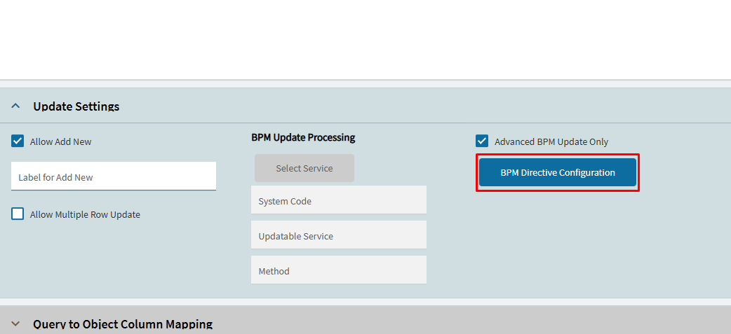

Trying to implement something similar. This is my first time using an updatable BAQ and I am struggling finding where to find GetList in BPM Directives.

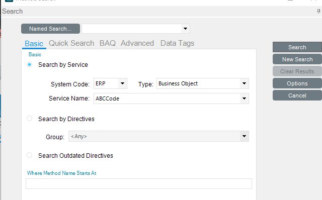

Using BPM Directive Configuration from within the BAQ designer returns no results:
Additionally, I don’t see any way to add a directive to this table and begin working on it.
To set this up, do I need to create a new BPM on the GetList method. If so, is this a ERP.BO method, etc?
Any help would be much appreciated! I have been looking through as much as I can find on google and haven’t been successful.

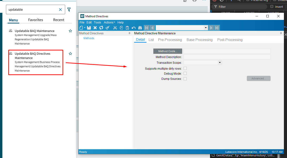

I am able to open the classic customization of ‘updatable baq directives maintenance’.
However, this just appears to be the regular BPM maintenance application and I have to begin by searching and selecting an existing method code.
Open the classic baq designer and do it from there.
