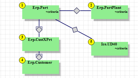

I have a BAQ

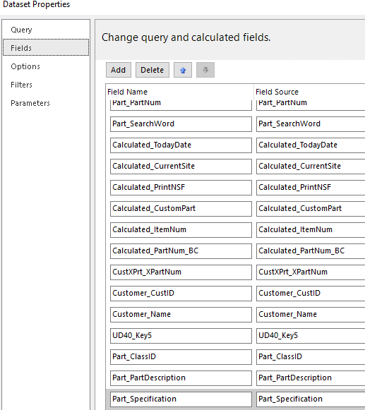

where I added the Part.Specification to the Displayed Fields. Saved and ran BAQ successfully. I then opened the SSRS report, went to
and updated the query to
=“SELECT [Part_PartNum],[Part_SearchWord],[Calculated_TodayDate],[Calculated_CurrentSite],[Calculated_PrintNSF],[Calculated_CustomPart],[Calculated_ItemNum],[Calculated_PartNum_BC],[CustXPrt_XPartNum],[Customer_CustID],[Customer_Name],[UD40_Key5],[Part_ClassID],[Part_PartDescription],[Part_Specification] FROM dbo.[BAQReportResult_” + Parameters!TableGuid.Value + “]”
I then added the Query field as instructed in other articles. (Does it matter if query field was added before changing actual query?).

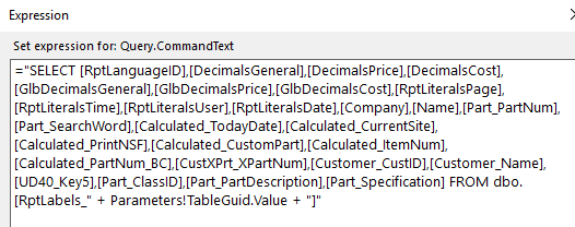

I also did the above for RptLabels:

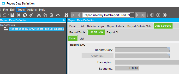

One thing you can check is if you see the updated fields in your report data definition that is found on your report style for this BAQ report. If they aren’t in the report data definition (RDD) then I don’t think they are going to be generated for the report dataset and therefore the SQL query is going to return nothing for those fields.
hi Utah,
I went to the RDD, but I don’t see anything. Everything is “grayed” out. Am I supposed to export it, make changes, and reimport it… OR something like that.

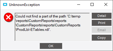

I went back to the BAQ Rpt Designer, Action Menu, Upload SSRS Report… and received the following error message:

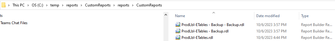

Now I know the file is there. Here is the screenshot:

Read that again. That is not the same path.
Hi Kevin, I have looked at the path in the error message and the path in the File Explorer screenshots a few times. Where is the difference between them? Just not seeing it…
Ok, I see it now. CustomReports appears 3X. Thanks
Error Message Path:
  • C:\temp\reports\CustomReports\reports\CustomReports\reports\CustomReports\ProdLbl-ETables.rdl
Path you showed:
  • C:\temp\reports\CustomReports\reports\CustomReports\ProdLbl-ETables.rdl

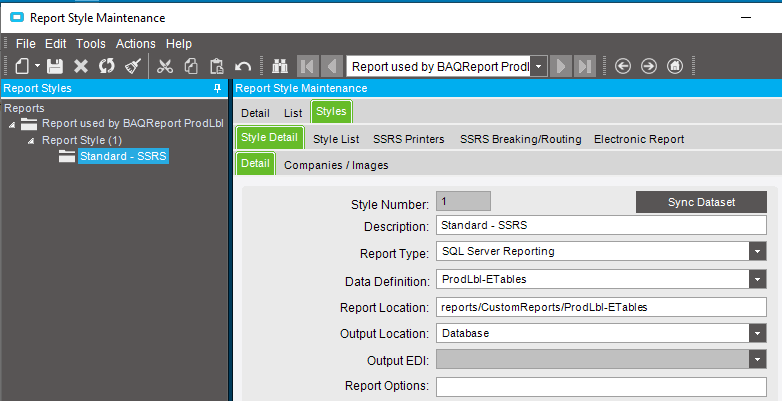

Ok. So I saved the .RDL file on my desktop as you saw in File Explorer. I have the SSRS report that I downloaded from the server. Here is the Report Style
When I try to upload from BAQ Report Designer, it adds the extra reports/CustomReports. I gather it is getting it from the Report Style. The Report Style worked before I added the field Part.Specification. Should I change the “Report Location”? This is where it resides on the server. Also, I get an error that filepaths cannot exceed 260 characters. Should I just move the ProdLbl-Etables.RDL to the C:\ Temp folder? More complicated than it needs to be I’m sure…
Move your reports to c:\temp\reports\CustomReports\ProdLbl-Etables.
When you upload, you just chose the folder c:\temp.

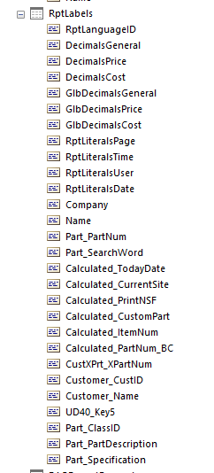

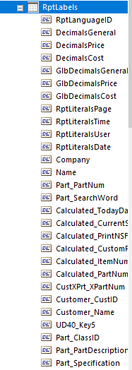

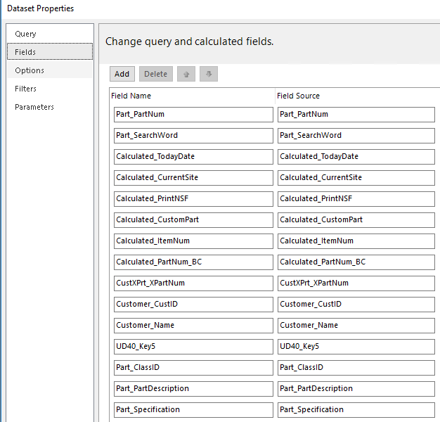

Some screenshots from Report:
I think I have all the pieces updated as they need to be. The BAQReportResult has the same modifications as above.
Thanks for all your help! What could I be missing?
You originally said you “did the same thing for RptLabels”. I would go back and undo that. Take the Part_Specification field out of that query. You probably don’t use the RptLabels dataset, so I wouldn’t bother updating it.
Open the same Report ID in Report Style. Look at the “Report Location” field on the Styles > Style Detail > Detail tab. Methinks there is a typo in this field. You can see from your posted error message that it thinks the file is in temp\reports\customreports… yadda-yaddah. Just verify the path that should be here based on where the rdl file is sitting on your PC. Update this to match, then try the upload again.
