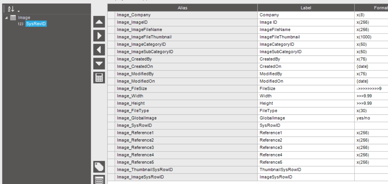

Mr. Jose: So if i create a BAQ for the purpose of a BAQReport what field should i include that SSRS can read as an Image?
You can read the image table and use the ImageSysRowID to then join to Ice.FileStore, in your SSRS query, to pull back the content field to an image control

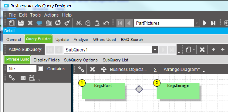

Mr. Dan: I am trying to write a BAQ for a BAQReport to show pictures of parts.
In the BAQ Designer - I am unable to add the ice.FileStore table. Is there a trick or security secret i can use to make that table visible.
I understand i could reference the table outside of Epicor - however, if i could keep it all in Epicor then I would not have to worry about referencing the pictures in the Live DB if i am running in Pilot.
With a BAQ Report you cannot pull in Ice.FileStore, so the only option is to go directly to the data from SSRS. Now this can be made easier to handle for pilot or live by how you get this data (placement of a view) but any way you do this they each have maintenance requirements. I typically will put a view in the Report database and then join to that. So Pilot would have a view named Image that pulls from Pilot DB and Live has a view named Image and that pulls from Live DB. The SQL query always pulls the same named view and it handles the different databases. Like I said - many ways to make this easier but all require proper maintenance.

Update - we still cannot add the FileStore table to a BAQ.
So we will NOT be able to create a BAQ report that shows part images.
