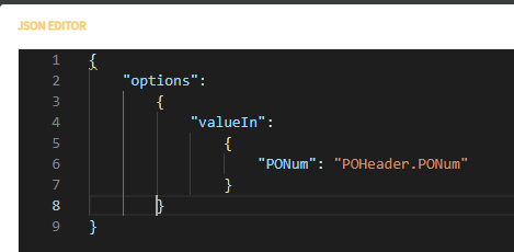

Thanks for the reply Banderson… Since new to the forum and this is the first post, just updated the issue. In PO screen, in button click, using app-open event, calling baq report designer and doing the json code in launch form options as shown below.

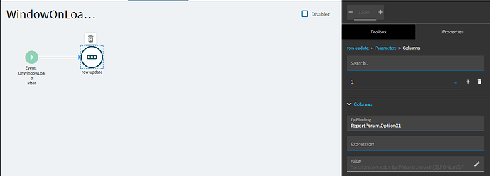

Similarly , in baq report designer, after form load event code shown below…
While running the report, getting error as shown below.

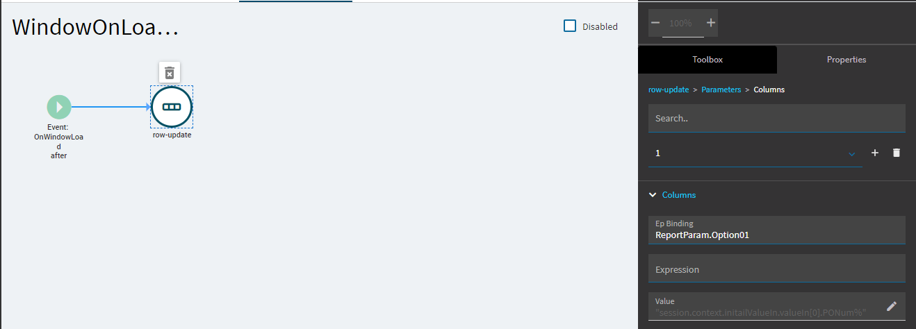

I tried as per the link and still value is not getting passed…

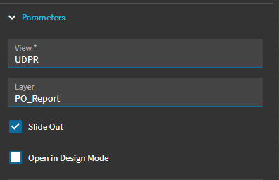

Launching App
“UDPR” is the Menu ID where this BAQ Report is mapped and “PO_Report” is the layer name.
Receiving App
Please let me know your suggestions.
Syntax matters.
Your session variable is still wrong. Additionally, it goes in the expression field, not the value field.
Syntax error in Launching application??
Session variable.
I tried like this this… but still value is not getting passed…
“%session.context.initialValueIn.ValueIn.PONum%”

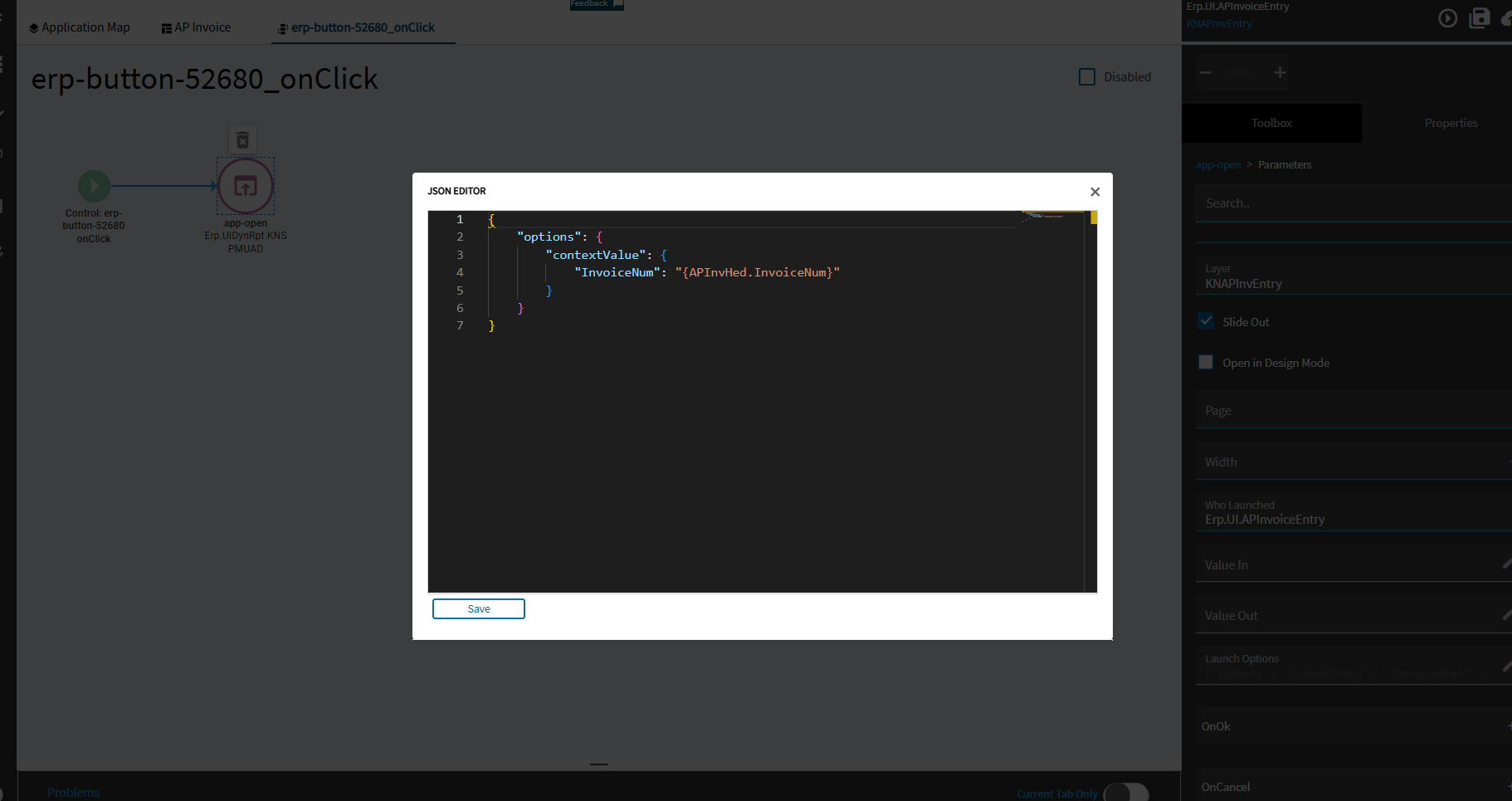

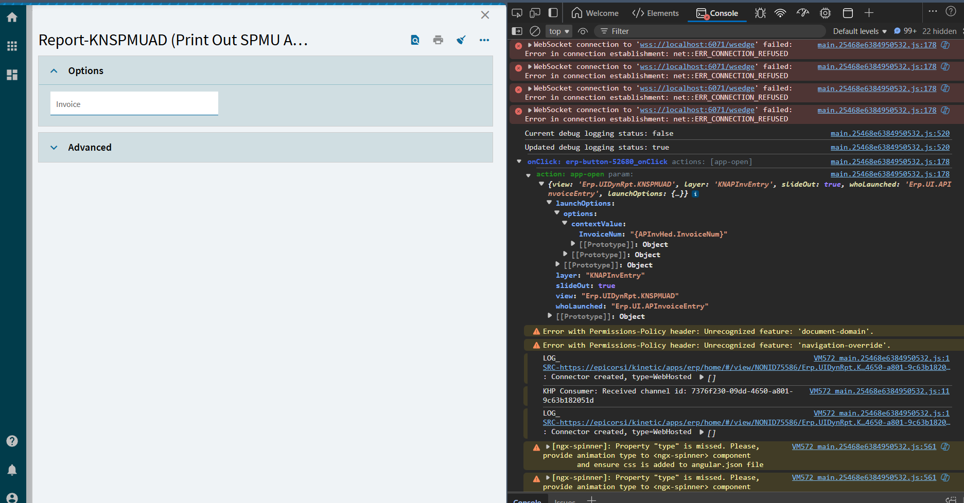

Hi, @hmwillett Would you help me? i’m stuck and newbie in epicor.
Launch APP:

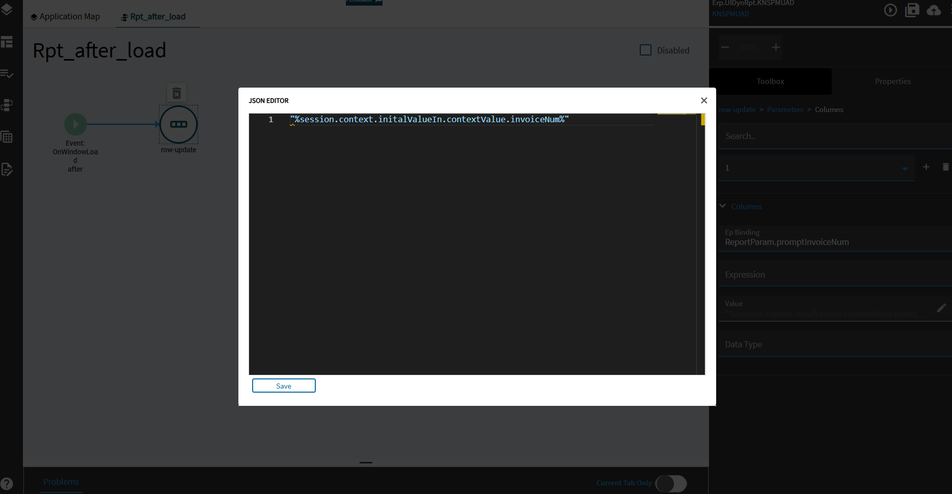

Receiving APP:
but when click button print, parameter invoice num in report option not updated
