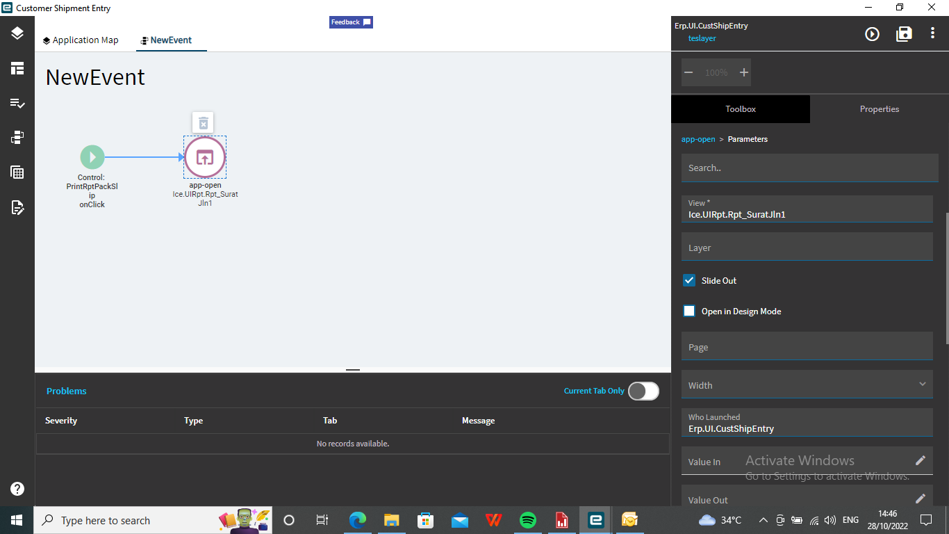

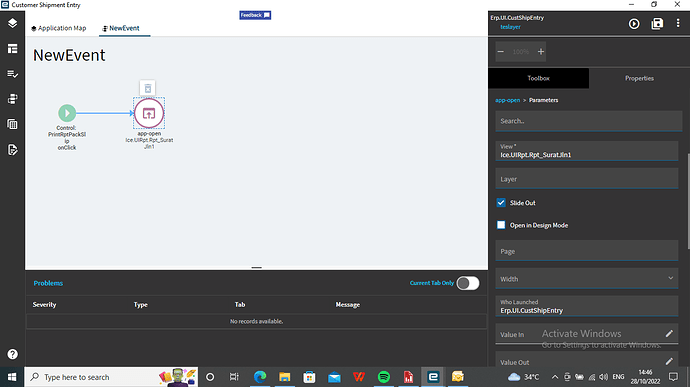

Create open BAQreport in CustShipEntry using application studio
i am a beginner in epicor. here I tried to create a custom button to open the baq report I created from the custshipentry form, but when I preview then I click. the report form does not appear, can anyone explain to me how to create it? i really need it

Your best bet is to open Dev Tools to find out if it’s tossing an error.
Thank you @hmwillett , it’s resolved, I just misplaced the order of events that were there. My next question is how do I send the packnum paramater that I am opening in the shipment entry so that when I print the report only the packnum is printed.

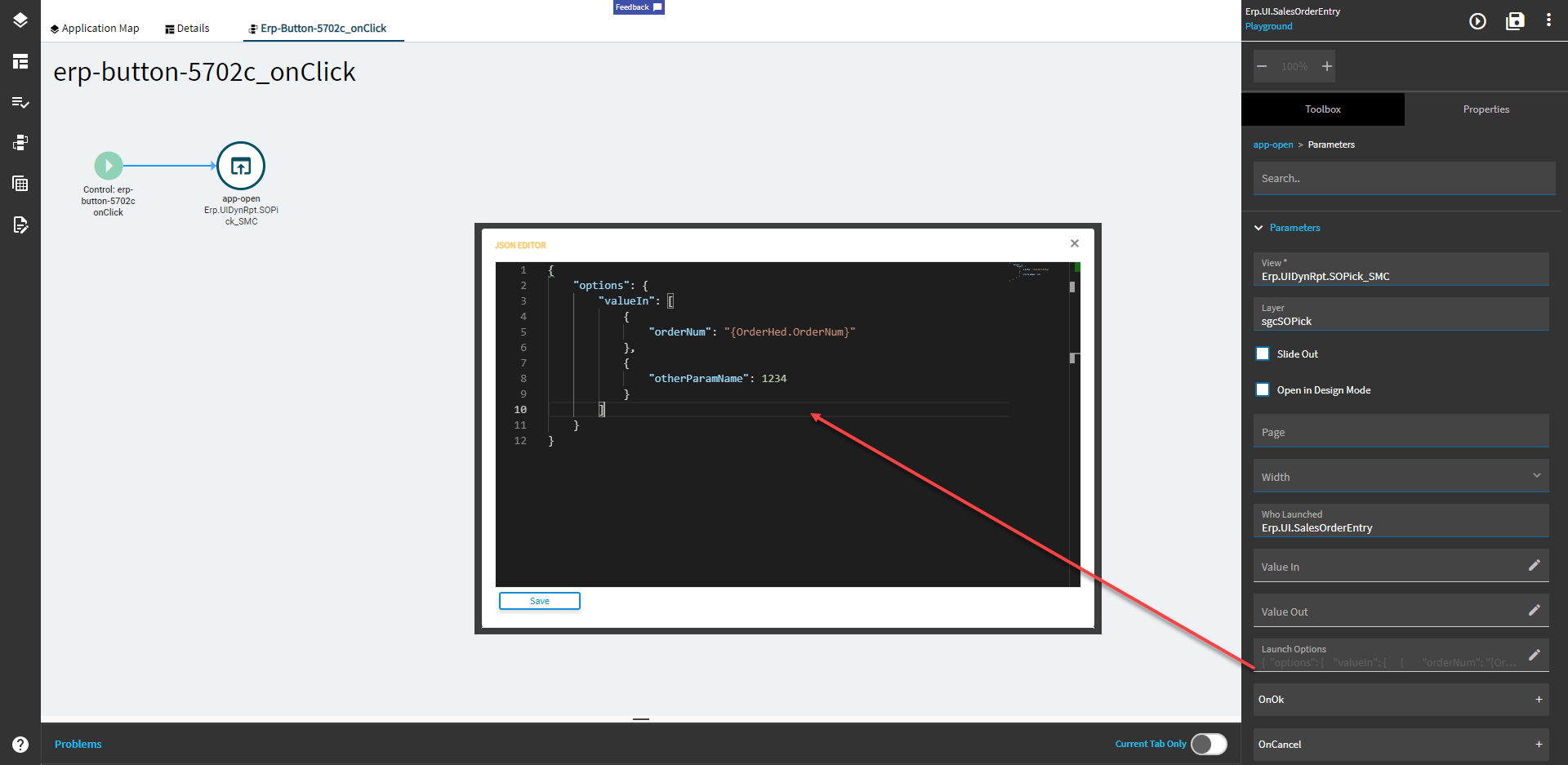

Passing values to app-open tile - Experts’ Corner - Epicor User Help Forum (epiusers.help)
Thanks @hmwillett i will try

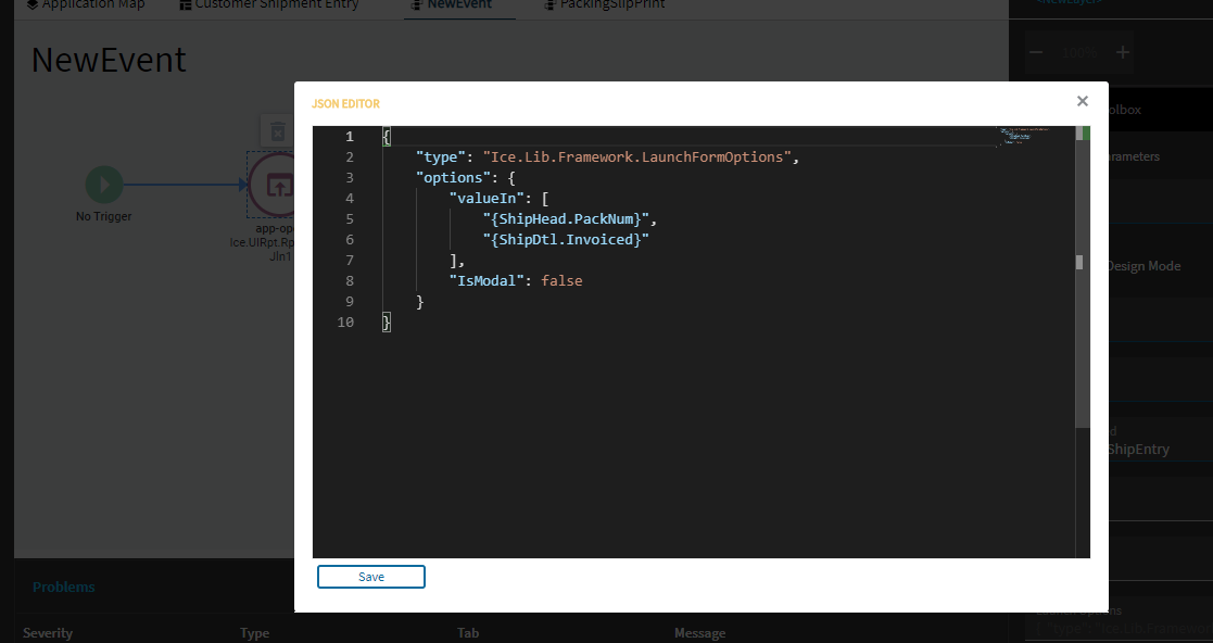

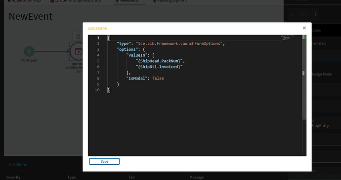

I’ve made a json script like this.
next how do i make ssrs accept those parameter throws?

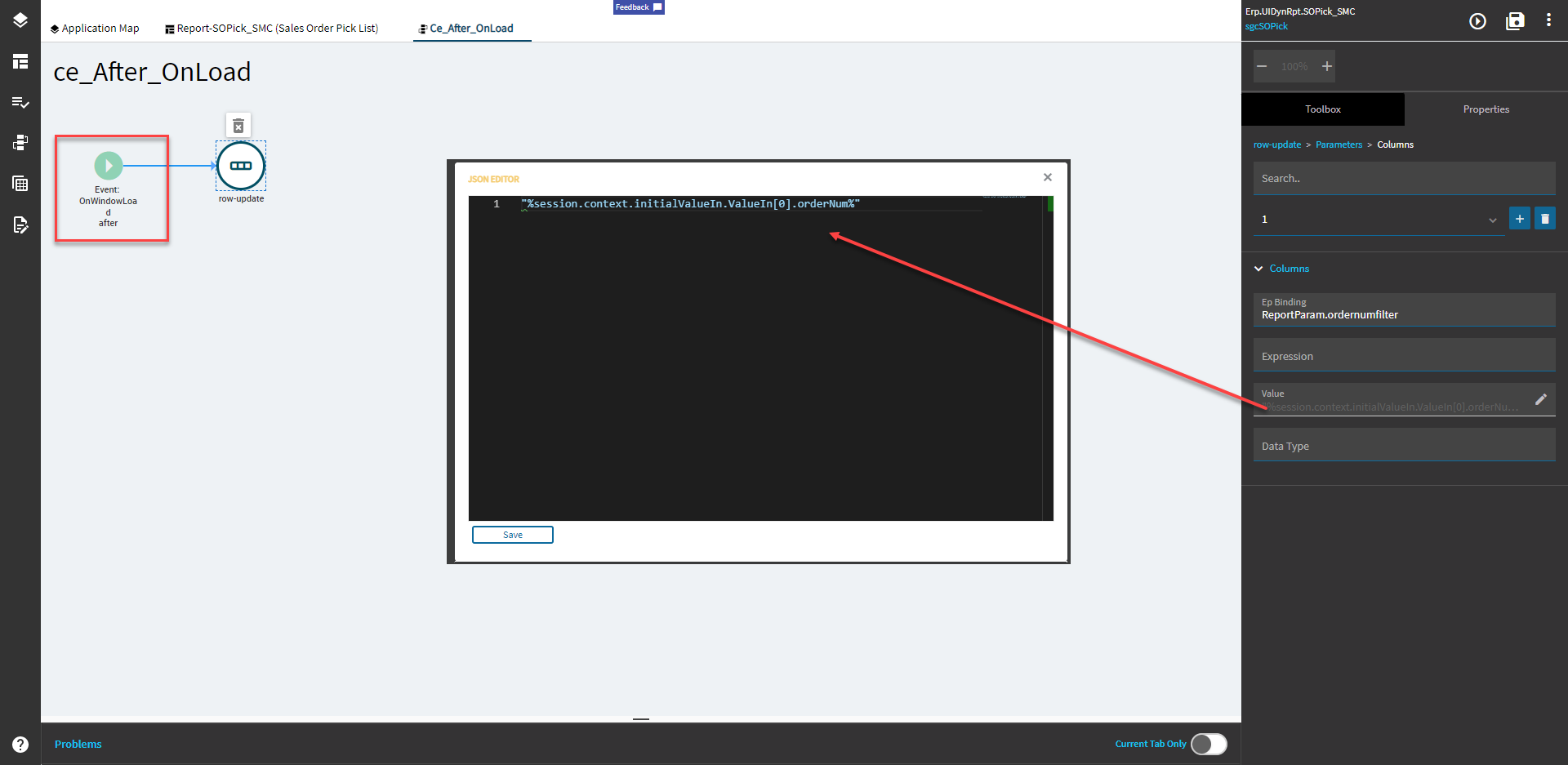

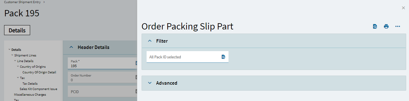

I want the baq report options to be automatically filled with the packnum I open
can you help me with this, I’m stuck @hmwillett

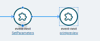

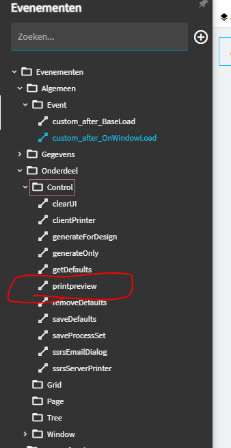

Is it possible to lauch ‘printpreview’ directly after opening app with the necessary parameters?
I tried to set ‘printpreview’ as next-event, but somehow it doesn’t get the trigger after custom_after_OnWindowLoad has been triggered to set the parameters.

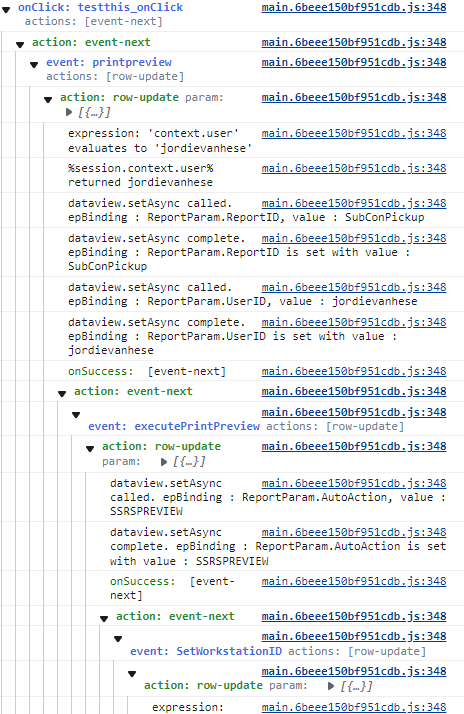

Track the events that are called in Dev Tools when you manually do a print preview and copy those including their values.
I did that and ‘printpreview’ should be the only method to trigger.

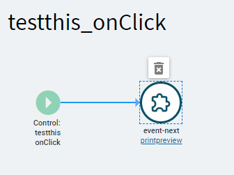

I double checked it by adding a button that only triggers ‘printpreview’
What i miss is the Dev tools view when opening an app from another application. CNTR+ALT+8 can only be triggered after the method to autoprint is already triggered. :frowning:

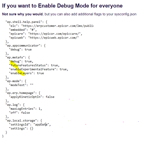

There’s a setting somewhere where it’s turned on everywhere by default. It really slows down the system, but it’s quite useful for things like that. Lemme try and recall where it was.
oeh that would be nice! thanks alot!
That’s on the server located in: C:\inetpub\wwwroot<AppServerName>\Server\Apps\ERP\Home
You only need
"ep.metafx": {
   "debug": true
Thanks, I’ll ask Jos to change this setting on the server :+1:
