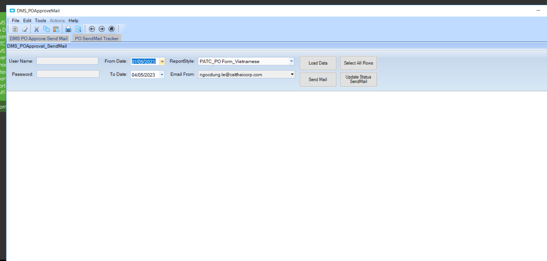

How to close MainController in form load
I want to check if the user has permission to enter the screen by letting them log in before opening the formLoad, if not, I want to close the form here but I can’t.
normally I just call this.Close()
But in epicor can this close event be used?

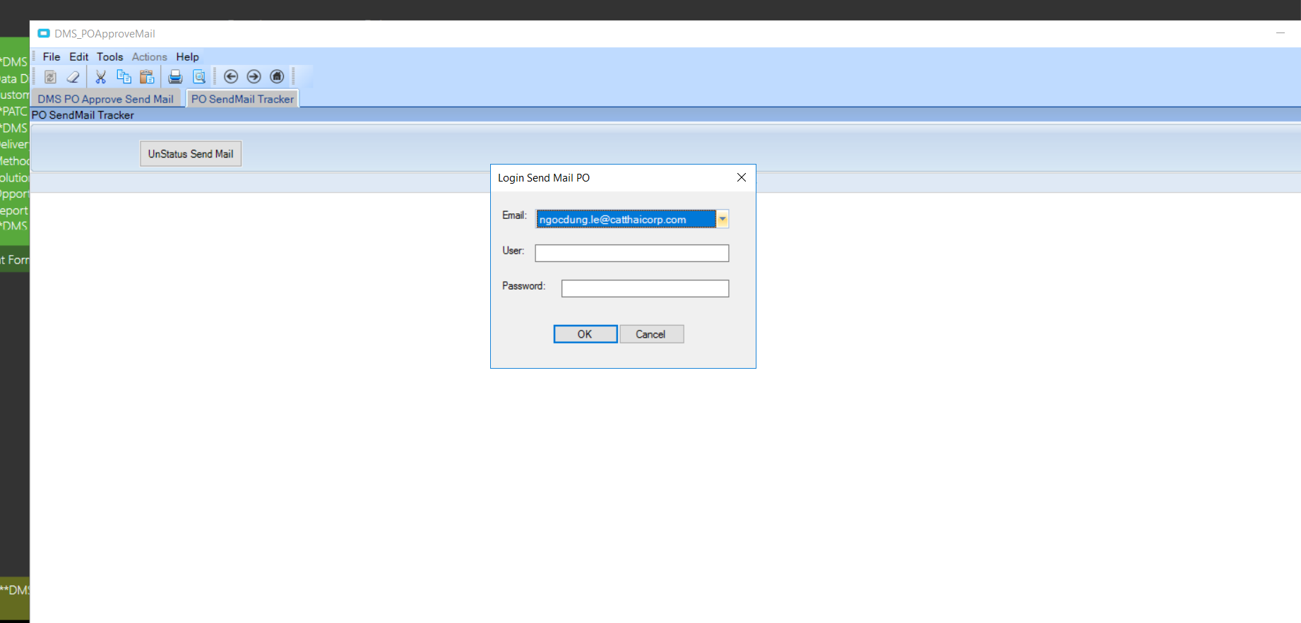

is there a solution to help me close the form right away, formload if I use Application.Exit( ) then shut down the whole program
I use the FormShow event that occurs after the FormLoad to solve the problem

Can you try:
MainController.BeginInvoke(new MethodInvoker(MainController.Close));
toolTip_epiButtonC.SetToolTip(this.epiButtonC_UpdateSendMail, "Sử dụng nút này để cập nhật trạng thái gửi mail các PO đang được chọn! (PO được gửi mail thủ công)");
		DialogResult dr = frmLogin.ShowDialog();
		if (dr == DialogResult.OK)
			LoadDataInfo();
		else
thank you, i made it!
