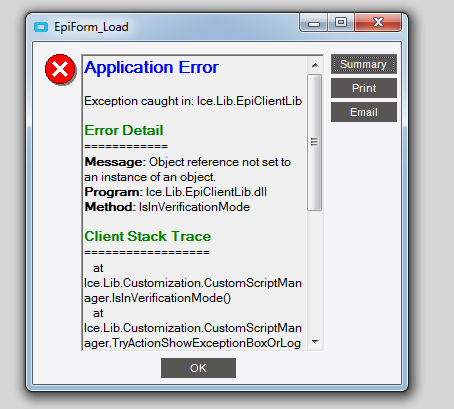

But getting object reference error . screenshot for reference.
The problem is while closing todolist screen i am trying to close requisition entry also .
On page load of requisition entry i called to launch todolist, while closing it is again hitting page load. how to avoid it.???
