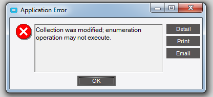

		foreach (Form f in Application.OpenForms)
		   MessageBox.Show(f.Name);
			if (f.Name == "ReqEntryForm") //some check to make sure this is the right form
				//EpiBaseForm ef = (EpiBaseForm)f;
			    f.Close();
I am close to my required answer.
But i could not close the form.
Here is the exception i am getting at run time
Any suggestion?
This is where I’d start being quite careful, personally.
There are things you can’t do within an enumeration, and typically removing an element entirely is one of them. If you step out of the enumeration and close from outside the loop you may be OK, but I’m not sure how Epicor reacts to shutting down forms that way.
Yeah you are right. Fingers crossed…

Hi as you suggest i fixed by closing outside the loop by creating reference to loop. code as follows. it works fine:) thanks
Form formtoclose=null;
                formtoclose = f;
        if(formtoclose!=null)
        formtoclose.Close();

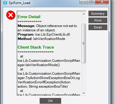

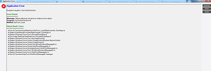

Hi but still while closing the form i am getting object reference error . may i know why and how to resolve it but collection error rectified
I wouldn’t be able to answer without working through the same thing myself, which I haven’t done.
As I suggested, Epicor may have trouble with simply closing the forms. My guess is that when you do so, there’s still some code running which is expecting that form to be there. You may be able to find a better place to do the closing, or you may have to delay the close somehow or hide instead of close or something, but the application probably isn’t going to make it easy.

so i coded the following codes on page load to close the requisition entry. It is closing but with error
            formtoclose = f;
EpiBaseForm frm = (EpiBaseForm)(csm.GetNativeControlReference(“GUID”));
frm.Close();
error screenshots i already uploaded in this thread. please browse up the post and check.

What you are trying to do is highly un-usual can I ask the million dollar question?
Why?
The issue you are running into is that there is some code that runs on form close which expects certain values to be loaded (which aren’t)
You may be better off just doing this outside of Requisition Entry. Invoke the TODO list directly from a different screen.
However I always go back to the why? What is the need being addressed? and is it reasonable?
Our client requirement to make this as a stand alone. I dont know the reason behind this. yeah it is very unusual But?..
How to directly invoke todolist from different screen.???/ In which method?
The same way
" oTrans.InvokeToDoList();"
