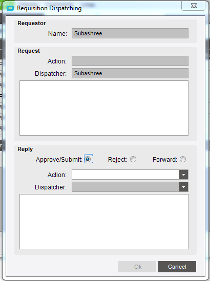

How to open the requisition dispatching screen on button click
very urgent… plz help with code.
I am trying to do but cant get menu id. any code help is highly appreciated.
It is a popup screen from to do list on requisition button click from requisition entry.
I need to open the requisition dispatching on button click

I have just customized this screen with all the functionality as in the base. Now i can get the menu id to call this customization on button click. This is the proven solution for this problem. But what i am expecting is i need to open this way - on button click but i cant get the MENUID to call the Dispatch screen. any other way to do this?
LaunchFormOptions opts = new LaunchFormOptions();
//MessageBox.Show(txtKeyField.Text.ToString());
opts.ValueIn = txtKeyField.Text.ToString();
ProcessCaller.LaunchForm(oTrans,“MENU ID”,opts);
This is an internal screen not accessible via a menu call.
