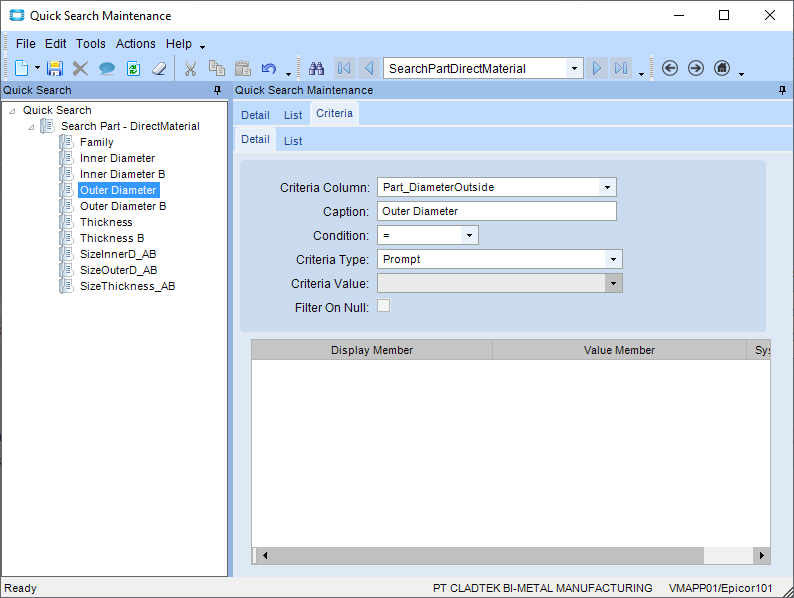

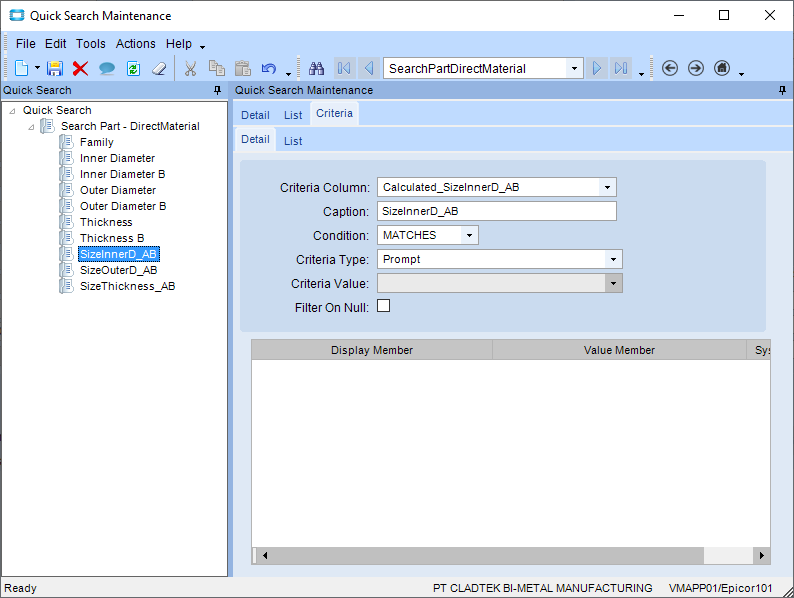

Maybe, you mean use function “Like” same in SQL for find similar result.
you can use Quick Search and Use BAQ for built it.
  1. This Equal Result
  2. This “Like” Result
  3. This to Access the Editor Quick Search
    2021-07-02_09h37_40
I hope, it will help you
Warm Regards,
Sukmo Aji - Cladtek Batam, Indonesia
