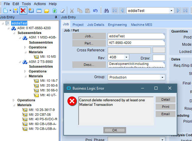

How to delete a test job - need to delete the material transaction?
With people on this forums help I was able to roll back the labor, and return the material we picked to inventory, but before I can delete this test job I need to delete the material transaction. Can someone point me in the right direction?
If this job has an Issue Material record, then you cannot delete the job, because these issue material records are recorded in the PartTran table and cannot be deleted by normal methods.
you can check the material transaction via Job Tracker or Job Status Dashboard
