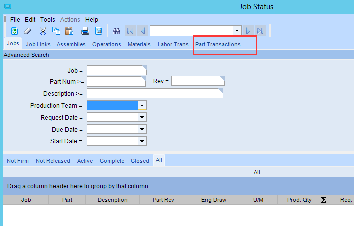

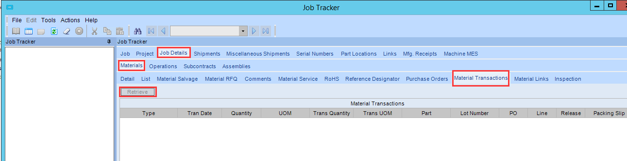

you can check the material transaction via Job Tracker or Job Status Dashboard
