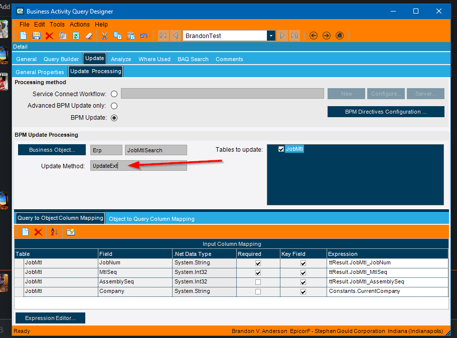

It depends on what code or method is being called in the updateable dashboard. If you let Epicor do it’s generic thing, it’s probably going to be updateExt, so you’ll need to have a BPM there as well as Update.
This tells you what method it’s using.

The MasterUpdate Method does a bunch of things and then calls Update.
The UpdateExt Method does a bunch of things and then calls Update.
Move your BPM to the Update method and it should fire for both.
